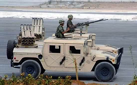

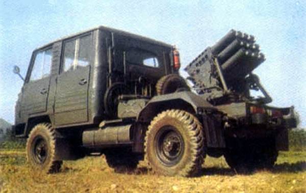

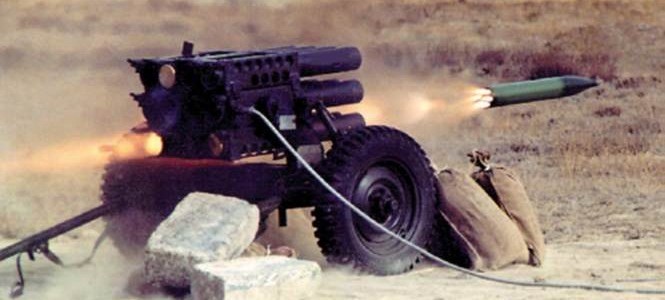

Ruotsalainen englanninkielinen tutkimus vastatykistötutkan käytöstä savimajasotaskenariossa 107 millimetrin raketteja vastaan vuodelta 2012. Raketin tutkapoikkipinta-ala RCS näyttäisi tuon mukaan olevan hyvinkin pieni, -30 dbsm = 0.001 m2. Aspect angle on maalin ja tutkan välinen suuntakulma heittimeltä katsottuna.
Radar detection of artillery rockets
Abstract:
This report examines how a radar sensor’s ability to detect 107 mm rockets depends on sensor positioning in relation to the protected asset. Field trials, intelligence and combat experience have shown that these rockets are commonly used and among the most difficult to detect with radar sensors. By using U.S. and U.S.S.R. documentation on rocket ballistics together with existing theories of detection range dependence on radar cross section (RCS) and a RCS description provided by FOI, a model for range gain for various sensor positions is constructed. MATLAB results shows that sensor positions within 300 meters of the protected object at a firing range of 3000 meters are favourable. As a rule of thumb, to achieve maximum sensor performance, the sensor should be placed not farther from the protected asset than 10% of expected rocket firing range.
Keywords: C-RAM, rocket artillery, radar, RCS, detection.

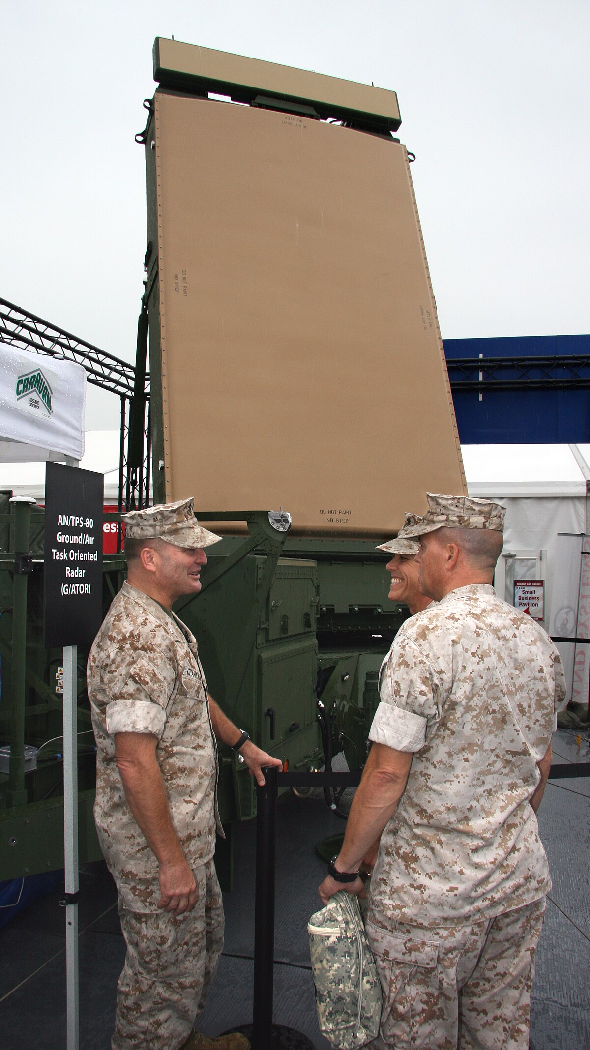

Törmäsin muuten mielenkiintoiseen tietoon. Amerikkalaiset neuvovat netissä (The Preventive Maintenance Magazine), miten estää kymppitonnien vaurio vedettäessä generaattoria. Suomessakin voitaisiin perustaa vastaava julkaisu Ruotuväen rinnalle. :p
NEWS | April 21, 2020
AN/TPQ-53: Bumpy Ride Busts ACPIA​
Heeding this article could save your unit over $60,000
AN/TPQ-53(V)
AN/TPQ-53(V): Shelter VPC-95 and Antenna TPY-3(V) (Courtesy photo)
The AN/TPQ-53(V) radar consists of two (2) M1092 trucks, the VPC-95 shelter and the TPY-3(V) antenna.
A 45-percent failure rate of the AC Power Input Assembly (ACPIA) on the TPY-3(V) is happening due to operator error. The problem is that the switch box/generator on the PP-3106 power unit hits the ACPIA over rough terrain when pulled by the TPY-3(V) antenna system. The damage costs about $62,728 per incident.
PP-3106
PP-3106 power unit is in TM 9-6115-759-13&P (Nov 11)
Here’s the fix:
Pull the switch box/generator using the VPC-95 shelter instead. It allows enough clearance over rough terrain to prevent damage to the ACPIA.
Switch box and generator
Antenna TPY-3 pulling switch box/generator.
The ACPIA is on the rear of the TPY-3 (Courtesy photo)
Damaged ACPIA
Damaged ACPIA (Courtesy photo)
Also, make sure the towing pintle on the M1092 truck is extended. That maximizes clearance.
Tow pintle extension
Fully extend towing pintle on truck (Courtesy photo)
And be sure to disconnect the cable from the 60-kW generator on the TPY-3 before transport. Then you can avoid the damage that can occur if the power cable is still connected to the ACPIA when the truck is driven away.
Damaged ACPIA
Damaged ACPIA due to cable being left attached (Courtesy photo)
Visit PS Magazine’s milSuite group for more guidance, including CECOM GSA 2018-003, the related ground safety action message:
https://www.milsuite.mil/book/docs/DOC-788477
https://www.milsuite.mil/book/docs/DOC-788511
