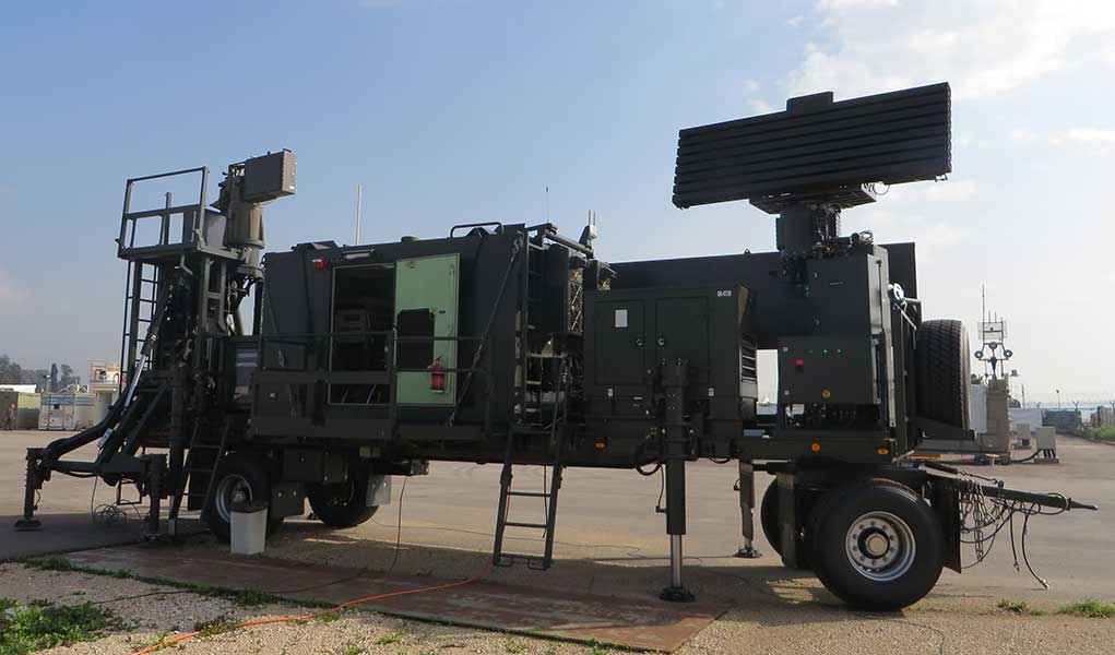

IAI on kehittänyt fiksunoloisen tuotteen Sky Capture, jolla saadaan vanhoistakin tykeistä yms. tehoja. Järjestelmä on räätälöitävissä eri asejärjestelmille ja tarjoaa modernin C2-kyvyn yhdistettynä kahteen tutkaan ja erinäisiin sensoreihin. ELTA ELM-2106 ATAR-tutka ja L-alueen tutka kuuluvat varustukseen. Helikopterit havaitaan ja tunnistetaan jopa 40 km päästä lapaheijasteiden ansiosta. Pienet maalit kuten UAV:t jopa 60 km päästä.
Sky Capture is a command and control system for anti-aircraft artillery and Very Short Range Air Defense (VSHORAD) systems that transforms legacy air defense systems into modern, accurate and effective weapons by applying modern sensors, communications and computing capabilities.
The system integrates several sensors, including target acquisition and fire control radar systems, including the ELM-2106 Advanced Tactical Air-Defense Radar (ATAR). This 4th Generation 3D is optimized to detect targets with low radar cross-section, such as low-velocity UAVs and ultralights that can be detected from 40-60 km. The ATAR radar can detect helicopters at 40 km, and classify such targets by type, according to the radar signature returned from the rotor blade returns. A solid-state L-Band medium-range radar. This radar combines rotation in azimuth with electronic scanning in elevation.
The system also combines an electro-optical (EO) payload for passive track and target identification. System. For the Sky Capture solution ATAR is associated with a separate fire control radar providing effective target engagement with continuous search and tracking of multiple targets. The solution provides accurate target data for the weapons associated with the system and manages to fire parameters to ensure the highest probability of target kill, according to the target type. Typical weapons controlled by the system are the Bofors L-70 cannons and ZSU-23/2 automatic guns.
https://defense-update.com/20181029_skycapture.html
