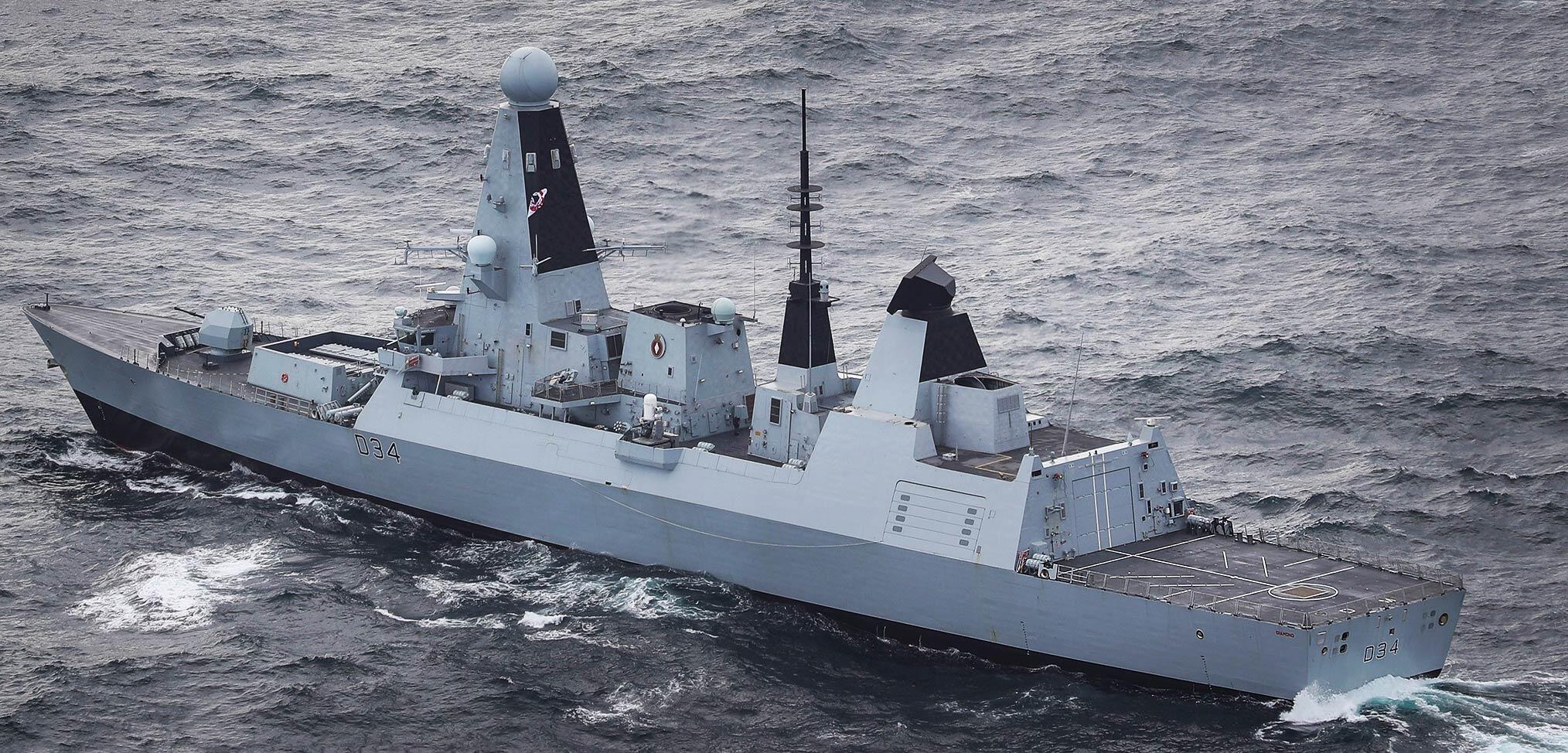

The Type 26 frigates will be fitted with the Mk41 VLS which may indicate the RN is already thinking of moving away from the ‘orphaned’ Sylver of the Type 45 and standardising on Mk41.
