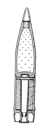

Rocket Assisted Projectiles tai RAP
Improved projectile performance can be achieved in several different ways which to a certain extent can be combined in one and the same projectile. At present work is proceeding along three different lines, of which the first involves attempting to produce a low-resistance projectile where the air resistance is reduced to a minimum. This work has resulted in longer and slimmer projectiles. The second line involves work that has been concentrated around reducing the base resistance of the projectile, caused by the stream of air round the projectile generating a lower pressure immediately behind the projectile base than in the surrounding air. The third line consists of equipping special projectiles with their own source of power in the form of a built-in rocket motor, so-called "reatiles" or Rocket Assisted Projectile (RAP).
Such a rocket motor is usually rigidly affixed to the projectile and gas evolved from an ignited propellant provide augmenting propulsion efficiency. Ignition of the rocket motor can be accomplished after leaving the gun barrel with a suitably designed ignition system contained within the casing, or ignition can be accomplished by means of the high temperature gases from the launching charge in the gun barrel.
http://www.globalsecurity.org/military/systems/munitions/rap.htm
Jos katsot tuota ammuksen alaosaa ja vertaa sitä kiinteään rakettiin (Solid Rocket Booster), niin kantaman lisäys tulee nopeasti esille. Näitä samoja ammuksia on kaavailtu myös RailGun projektiin. SBR tunnetaan hyvin ja se on ollut käytössä tuhansia vuosia.
