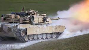

Let me start with the M1Abrams tank (since I'm a tanker).
It's a great piece of kit. In my view the best in the world.
And UKR tankers could spin up within a few days on that system. 7/
But here are some details:
-It has a 1500HP turbine engine, so it needs fuel similar to jet fuel.
-It gets 3 gallons/mile (not 3 mpg)...& it uses same amount of fuel even when idling
-the fire control systems is advanced technology, which needs a separate turret mechanic 8/
-A US tanker goes through weeks of training; a turret mechanic needs months
-The M1 has a "track" (or hull) mechanic who repairs the automotive system...he/she also needs months of training
-All tanks "break" in combat, & tankers try to "fix" their tanks...that's not good 9/
-Depending on the variant (M1, M1A1, M1A1Sep), the cost is between $2.5-8.9M
-If not treated right, the engines & transmissions "blow" easily (& that's expensive).
-It requires a lot of spare parts (what the army calls PLL or Prescribed Load List), & many fuel trucks 10/
While UKR tankers could certainly "man" the M1A1, they would have difficulty supporting it with mechanics, fuel, parts. And the costs would be astronomical.

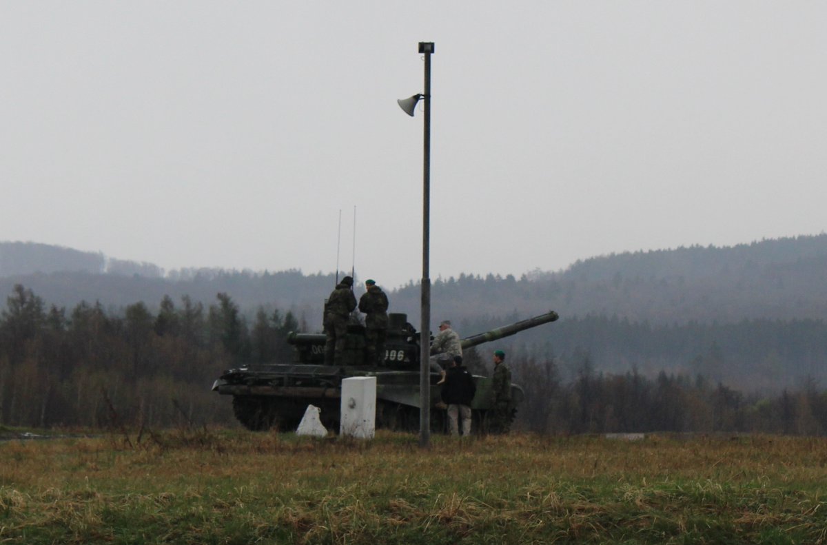

So, what about the T72? 11/
The T72 is an old chevy; the M1 is a Ferrari.
You get what you pay for (it's $.5-1.5M per copy).
The most technical thing in the turret is the autoloader, which the crew hates (it has a 3-man crew instead of 4-man like the Abrams).
It's a diesel instead of a jet engine. 12/
Several NATO countries (Czech Rep, Slovakia, etc) have "upgunned" the T72 with some technological modifications, and it's a better tank.
I actually shot one in the Czech Rep (and hit the target!). /13
![Image Image](/proxy.php?image=https%3A%2F%2Fpbs.twimg.com%2Fmedia%2FFPXIV0QXIAsDBRt.jpg&hash=564e3be46378163f13d8529bbfb09f77)
The UKR tankers know the T72 well...as they've even used to build this tank in Ukraine for the Soviet Army in the old days.
So the potential of a tank "swap" with other nations providing T72s is a good idea...my only concern is how to get them onto the battlefield. 14/

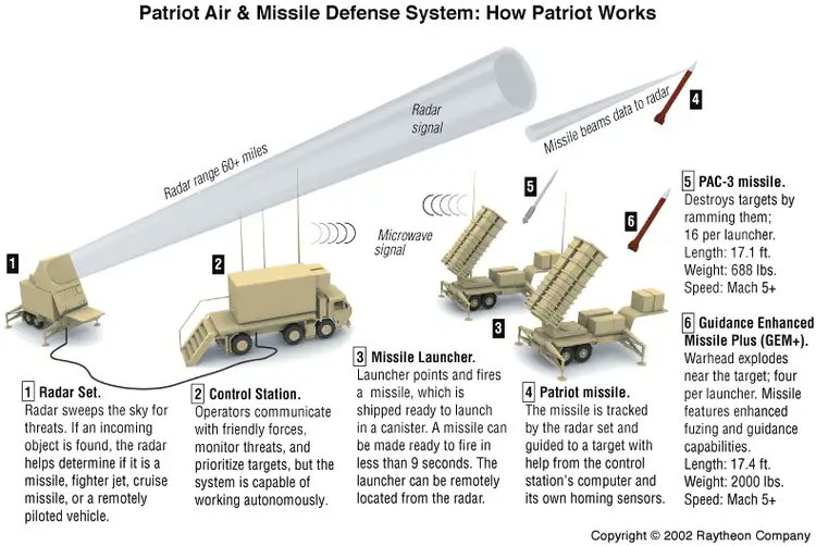

But what about the call for "PATRIOTS"?
After all, Poland & Bahrain just concluded a deal for them!?
The Bahrain deal included 60 Patriot missiles, nine launchers, two radar sets, control stations & other associated equipment.For $10B dollars.
Here's what it looks like 15/
The Patriot, like the Abrams, is a great system. But...
It requires an extensive amount of training for trigger pullers, more for those who run the C2 & radars, and even more for mechanics who keep the system running.
Nothing like the RU S300/400 or Buk, which UKR knows. 16/
