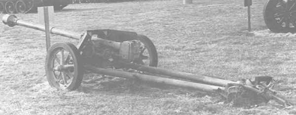

Tampellan m/57 lienee saanut vaikutteita saksalaisten 2. maailmansodan lopulla kehittämästä 8 cm PAW 600:sta. Sileäputkinen 81mm ase, jossa oli erillinen korkeapainepalokammio, jolla pystyttiin rajoittamaan varsinaisen putken huippupainetta.
"In 1943, a specification was issued for a lightweight anti-tank gun that used less propellant than a rocket or recoilless weapon, yet was sufficiently accurate to hit a 1-meter square target at a range of 750 meters. Rheinmetall-Borsig proposed a design to meet this requirement using the new high-low pressure ballistic principle, also known as the Hoch-Niederdruck system. In this system, high pressure caused by the combustion of the propellant was confined to the breech section, which was relatively heavy, and did not act directly on the projectile. The pressure was allowed to bleed gradually into the barrel at a controlled rate and lower pressure to propel the projectile. Thus the barrel could be exceptionally light for a weapon that still had the advantages that accrue from a high pressure gun. The carriage too could be very light, although the initial prototype carriages proved to be too light and had to be redesigned. The resulting PAW 600 (later redesignated 8H63) gun weighed about 600 kg, less than half that of the 7,5 cm PaK 40, while having comparable armor penetration out to its full effective anti-tank range of 750 meters."
https://en.wikipedia.org/wiki/8_cm_PAW_600
8cm-smooth-bore-ammunition-jpg.247871
