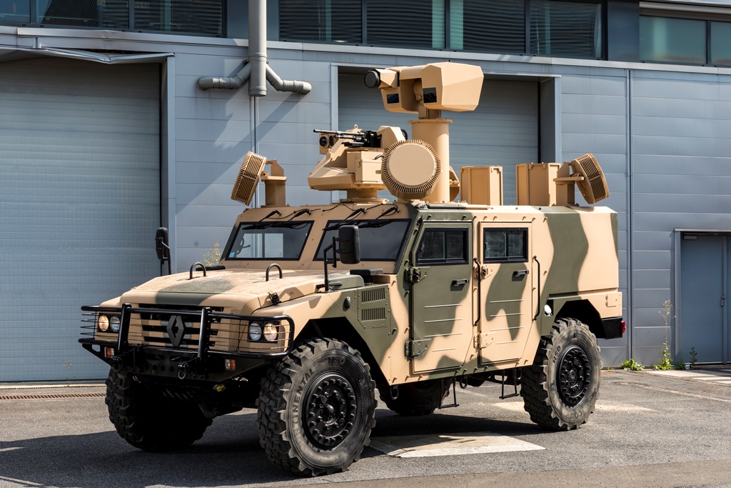

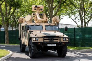

As said the Sky Warden is fully modular, therefore a customer can pick-up the subsystems of choice in order to tailor the overall system to the threat he needs to face. On the MBDA site at the Plessis-Robinson, on the outskirts of Paris, it was possible to see the Sky Warden installed over a Sherpa 4×4 armoured vehicle provided by Arquus, which roof was full of subsystems, although not all those aforementioned were present.
click on image to enlarge
At the corners we could find four AESA antennas, apparently MHR RPS-42 from Rada of Israel, each covering 90°, capable to detect a nano-UAS at 5 km and a medium-size UAS at 25 km range. These can be replaced by Saab Giraffe G1X radar that might also be installed on the roof, on a telescopic mast. At the centre a mast was carrying the HELMA-P middle power laser weapon from CILAS, capable to neutralise a drone at over 1,000 meters and damage its optics at 3 km. Between the two forward antennas we find a Hornet Lite remotely controlled weapon station armed with a 7.62 mm machine gun; such a weapon doesn’t fit into the C-UAS scenario, but this might indicate a possible evolution of that turret into a C-UAS system. It can also be replaced by the Openworks SkyWall net system. At the back of the vehicle we find the container/launchers of the hard-kill UAV, while the passive RF suite and the jammers were not installed. The Mistral missile system was installed on a second vehicle.
