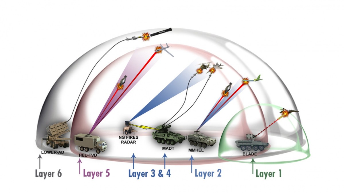

Drone-torjuntaan tarvitaan mielellään halvempia ratkaisuja. Tässä muutaman vuoden takaa USA:n armeijan hahmotelmaa sen omien joukkojen suojauksesta:
Tuolla Layer 1 tasolla on siis joukkojen omasuoja droneja vastaan.
Layer 1: BLADE (smallest, most mobile dome of protection)

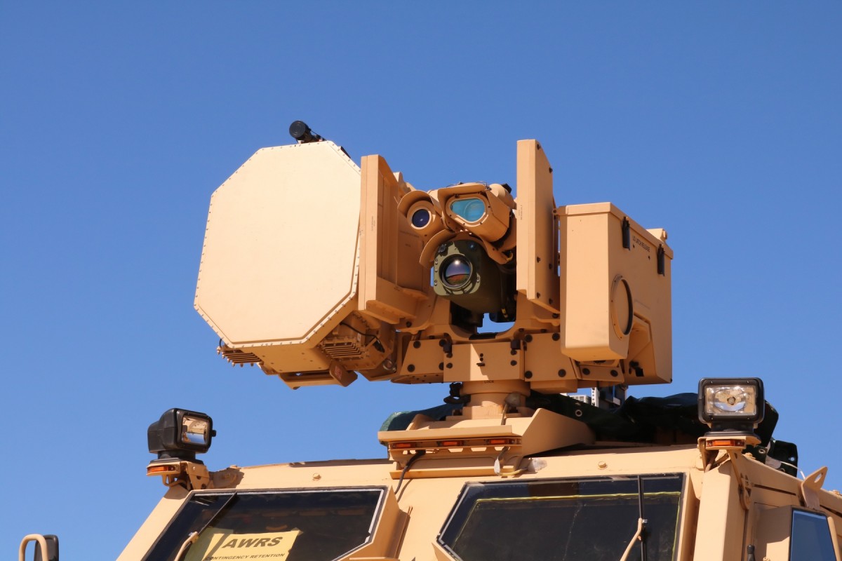

At the tactical edge, maneuvering Soldiers need to have local protection to shoot moving targets such as unmanned aerial systems (UAS), which range from Group 1 (very small UAS) to Group 5 (the largest UAS). The Ballistic Low Altitude Drone Engagement (BLADE) is a set of enabling technologies that are integrated with an armament system to defeat smaller unmanned aerial systems at close ranges, which includes the distance a Soldier can see a UAS without using binoculars. Its intuitive interface makes the BLADE easy for Soldiers to use.
The BLADE system works with the Common Remotely Operated Weapon Station (CROWS), and uses advanced fire control and precision targeting enablers to detect, track and defeat unmanned aerial systems. Mounted on a tactical vehicle, CROWS contains a sensor suite and fire control software that allow the warfighter to remotely engage targets. CROWS can engage targets during the day or at night, and includes a daytime video camera and a thermal camera.
Anyone who has fired a machine gun knows how difficult it is to hit a moving target; the radar and fire control software in the BLADE enabled it to hit a small UAS with a short burst of fire during an engineering test that the BLADE team conducted on prototypes in June at Fort Dix, New Jersey.
Layer 6 on LOWER-AD, eli edullinen noin NASAMS/AMRAAM tason suorituskykyinen ohjus joka on tehty edulliseksi.
Layer 6: LOWER-AD (largest dome of protection)
The Patriot missile system is instrumental in protecting forward-deployed forces, friends and allies against incoming air and missile threats. The CCDC Aviation & Missile Center is developing and demonstrating the Low-Cost Extended Range Air Defense (LOWER AD) missile interceptor technology that is smaller and less costly than larger systems. The LOWER AD project will demonstrate critical technologies to defeat subsonic cruise missiles and lethal unmanned aerial systems, leaving the advanced Patriot interceptors for the more stressing threats.
The LOWER AD technology will make it possible to reduce the size of the missile, which in turn will allow more missiles per launcher. Internal components of the LOWER AD missile technology will include improved navigation and a low-cost seeker and warhead, which will maximize its capability to protect defended areas and troops.
LOWER AD will conduct a flight test in fiscal year 2021, using various targets at extended ranges to demonstrate Level 6 maturity of the technology. A flight test with the ballistic test vehicle will be conducted in the fourth quarter of fiscal year 2019 to verify key component performance.
Sen lisäksi Layer 2 & 5 tasolla on eri laser-järjestelmät.
Suomessa Lower-AD + Layer 5 Laser voisi olla hyvä kombinaatio suojata kiinteitä kohteita. Ja Layer 1 + Layer 2 hyviä suojaamaan omia joukkoja.

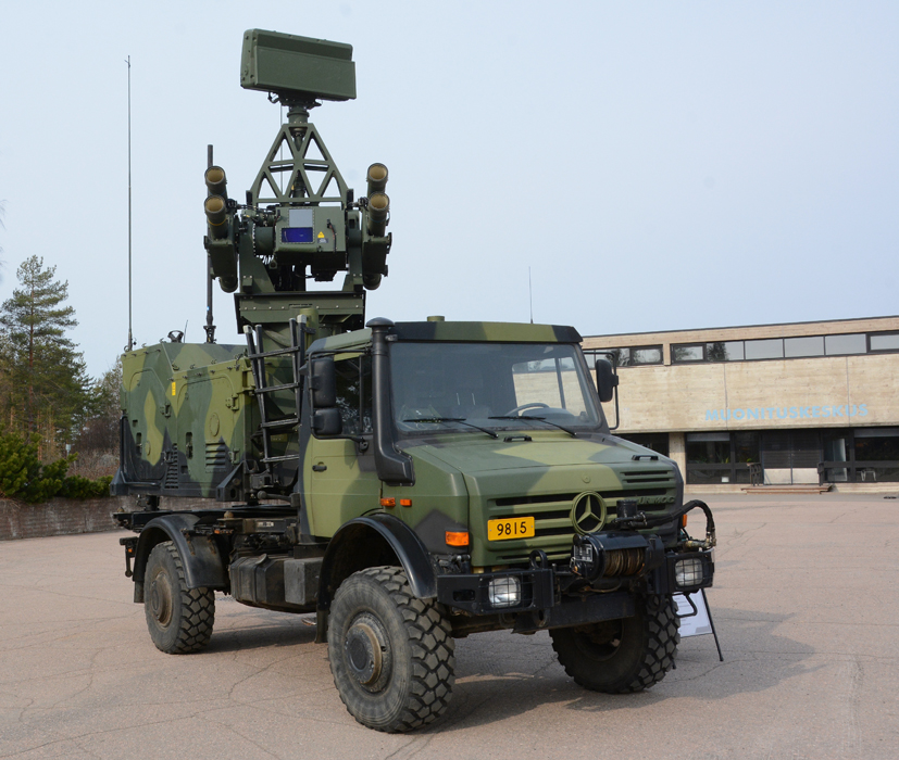

Mikähän mahtaa olla tämän ITO05 järjestelmän status? Käytössä on, mutta onko järjestelmällä tulevaisuutta, taitaa Suomi olla ainoa vastaavan konfiguraation (ASRAD-R) käyttäjä?
Näitä hankittiin aikoinaan 16 ohjuslavettia (4 patteria, 4 lavettia per patteri). Tarkoituksena oli nuo sijoittaa kolmen valmiusyhtymän + pääkaupunkiseudun suojaamiseen.
Oletan että järjestelmä soveltuu myös drone-torjuntaan, ainakin päivityksen jälkeen? Vastaava kevyt IT-ratkaisu voisi olla kätevä suuremminkin hankittuna, nimenomaan maavoimien taistelevien osien suojana drone-torjunnassa.
Missile Defense Advocacy Alliance osaa kertoa, että Suomeen ja Kreikkaan myyty järjestelmä on sama kuin saksalaisten oma Leflasys. Toki Suomella on järjestelmässä käytössä eri ohjus, mutta ohjuseron ei luulisi liiemmin näkyvän komponenttitasolla (maalinosoituslaser tulee mieleen ainoana isompana).
Kun muitakin käyttäjiä on ja kun järjestelmän käyttämä Bolide-ohjus on yhteensopiva meidän useiden kymmenien mieskuljetteisten laukaisimien kanssa, niin ASRAD-R ei liene mielekäs kohde ennakoivalle poistolle. Poistumassa on paljon tavaraa (Crotalet, Oerlikonit, Marksmanit, Sergeit...), joten koulutus-/varastointi-/huoltoresursseja riittänee järjestelmän ylläpitämiseksi myös jatkossa, vaikka korkeatorjuntakyky onkin tulossa.
Reserviläisen viimevuotinen artikkeli kertoo, että ASRAD-R saavuttaa elinkaarensa puolivälin lähiaikoina ja ettei päivityksiä ole suunnitteilla. Alla katkelma jutusta.
ITO05-hankintaan johtanut tutkimustoiminta käynnistyi jo vuonna 1996. Tavoitteena oli saada suorituskykyä silloisten valmiusprikaatien, pääkaupunkiseudun ja suurkohteiden suojaksi. Tietopyyntövaiheeseen oli edetty 1999 ja tarjouspyyntöihin 2000.
Kokeiltavaksi asti päätyi kolme asejärjestelmää: STN Atlas (nykyisin Rheinmetall) ASRAD-R, Thales ASPIC-Starstreak ja Matra Mistral 2.
Testien jälkeen 16 ASRAD-R-järjestelmää tilattiin vuonna 2002. Ohjustornista vastasi Rheinmetall, johtamisjärjestelmästä Oerlikon Contravetes Canada, Bolide-ohjuksesta Saab ja tutkasta Ericsson Microwaves. Kokoonpanosta Suomessa huolehti nykyinen Insta.
Oman haasteensa toi se, että ASRAD-R oli vasta kehitysvaiheessa. Ensimmäinen prototyyppi oli valmistunut 1998. Käyttöönotossa vierähtikin aikaa, koska Puolustusvoimien tarpeeseen rakennetusta järjestelmästä viilattiin erilaisia puutteita pois valmistajien kanssa. Tähän vaiheeseen kuului muun muassa ammuntoja Lohtajalla ja käyttö sotaharjoituksessa. Lopullisesti ITO05 hyväksyttiin sotavarusteeksi vuoden 2008 lopulla.
Varusmiehille Ilmatorjuntaohjuspatteri 05 -järjestelmän pääkoulutuspaikka on Salpausselän ilmatorjuntapatteristossa Vekaranjärvellä. Siellä jaossimulaattori mahdollistaa harjoittelun kahden ohjuslavetin ja ampumajalustan ryhmityksessä. Käyttäjät kutsuvat järjestelmäänsä ytimekkäästi nimellä nolla-viisi.
ASRAD-R saavuttaa elinkaarensa puolivälin lähiaikoina. Päivityksiä ei ole suunnitteilla. Suorituskyvystä huolehditaan kunnossapidolla ja yhteensopivuus käytössä oleviin johtamisjärjestelmiin varmistetaan.
