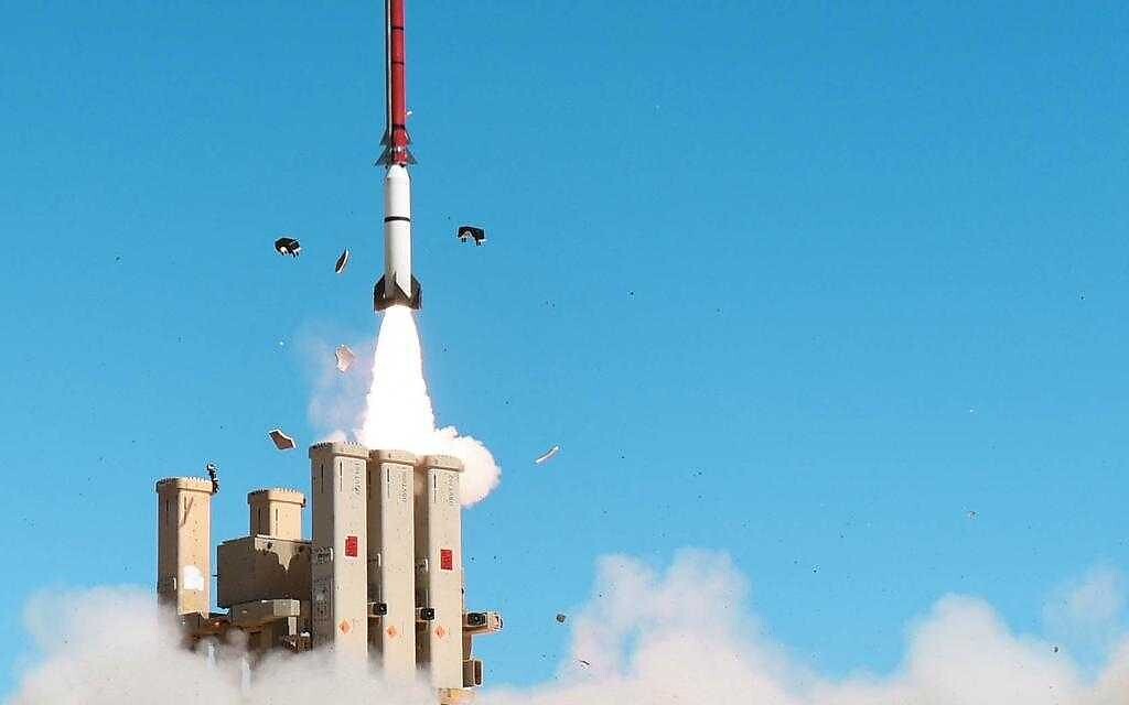

The Defense Ministry and military said Sunday that the Israeli Air Force and Rafael defense firm had successfully completed a recent series of tests with the David’s Sling medium-range air defense system.
According to a joint statement, David’s Sling faced off against “advanced threats,” expanding the system’s capability “and significantly improving the air defense layers of the State of Israel.”
“The existing capabilities of the system were tested in a number of challenging scenarios, which prove the capabilities of the system during conflict,” the ministry said calling it an “important milestone.”
