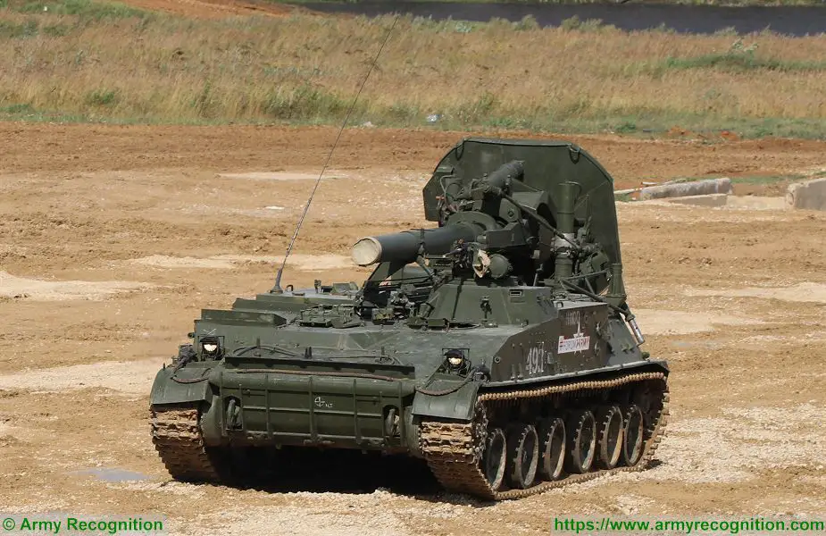

Russia__to_modernize_2S4_Tyulpan_240mm_self-propelled_mortar_on_tracked_armoured_925_002.jpg
2S4 Tulppaani. Naapuri on valinnut tämän alustan tehostettuun verkkosodankäyntiin.
Russian super heavy 240mm mortars 2S4 Tyulpan (Tulip) will fight in a network-centric war and exchange data with drones. They will be upgraded to destroy the most complicated targets by precision smart munitions. Experts believe the upgraded 2S4 will radically enhance artillery effectiveness, the Izvestia writes.
The Defense Ministry said complex modernization and restoration maintenance with extended life cycle includes barrel and recoil mechanism replacement. The main changes are related to communication systems, positioning and fire control. Their electronics will be changed. The biggest-caliber mortars will be included into a single tactical command level created to engage in network-centric warfare. The command level is designed for complex control of the troops and the use of navigational systems, as well as satellite and unmanned monitoring facilities. The Uralvagonzavod Corporation (UVZ) confirmed the plans to upgrade 2S4 but refused to elaborate the details of the project.
The mortar became operational in 1971. In 18 years the Ural Transport Machine-Building Plant produced 588 such weapons.
The Tulip can destroy practically all concrete shelters and defense fortifications. The artillery system is designed to destroy fortified buildings and erections, troops and armor accumulations, as well as targets invulnerable for other artillery guns.
The set of 2S4 projectiles includes Smelchak precision smart mines. They are targeted by a laser beam. The probability of hitting a circle with a diameter of 2-3 meters comprises 80-90 percent. The firing range is 20 km. and the set of projectiles comprises 10-20 mines. Tulip combat weight is over 27 tons. The mortar can fire shells weighing from 130 to 230 kg at a rate of one shot a minute.
https://www.armyrecognition.com/wea...mm_self-propelled_mortar_armored_vehicle.html
