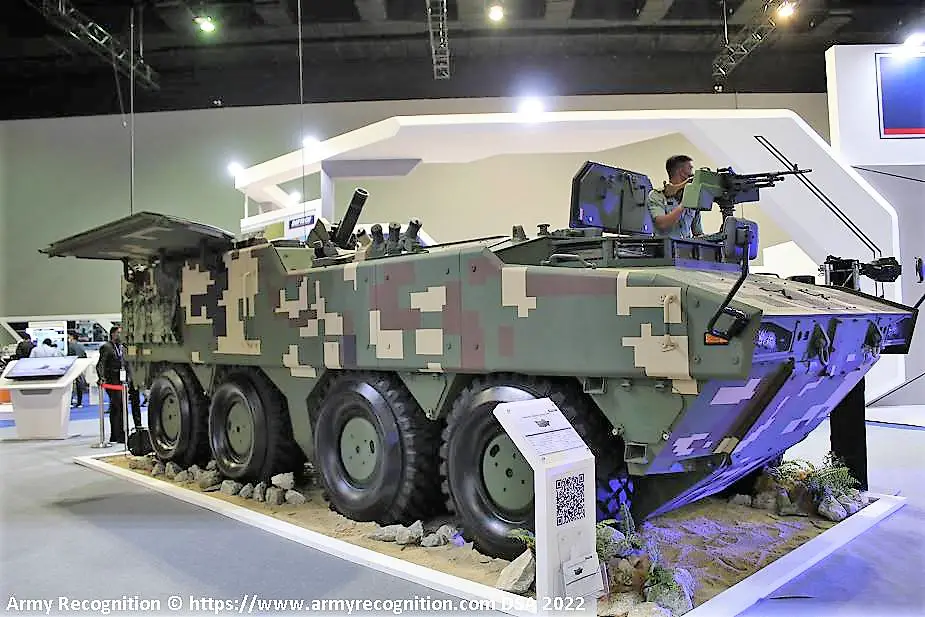

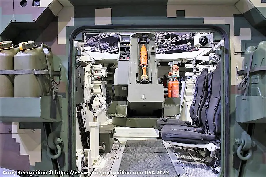

Malaysia’s Deftech is the main assembly agent, and its engineers worked with Nurol holding subsidiary FNSS to customize the vehicles for Malaysian requirements and equipment. South Africa’s Denel reportedly built a 2-man turret for the APC, while Sapura Thales was expected to become the systems integrator. The first prototype of the AV8 was presented in March 2013 to the public during the 80th Army Day anniversary celebration in Port Dickson, Negri Sembilan.
The AV8 will be delivered in 12 variants. A total of 178 AV8s will have an APC configuration with 30-mm or IFV-25 25-mm turret or 12.7-mm remotely controlled weapon station. Other versions include armored surveillance vehicles with battlefield radar and mast-mounted sensors (24), command vehicles (13), armored ambulances (9), armored recovery vehicles (9), maintenance vehicles (9), 120-mm mortar carriers (8), engineering and NBC reconnaissance vehicles (4) and signals vehicles (3).

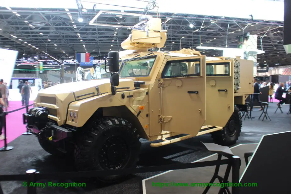

The Sherpa Light is a multipurpose, 4x4 armored vehicle, designed by Arquus to provide a wide array of versions and customizations for all needs and missions, built on a single, proven base for increased commonality and ease of maintenance.
It is a modern, mature, new-generation vehicle, which is built on many years of industrial experience, operational deployments on the battlefield, and maintenance. It is protected against ballistic and mine as well as improvised explosive device threats with a STANAG 4569-certified protection, which ensures a high level of safety for the crew inside the vehicle during operations.
The Sherpa A2M can carry 40 rounds of 120mm mortar ammunition in the rear and possibly additional ammunition in the cabin, depending on user requirements. It has a range of up to 8,2 km with standard rifled ammunition and up to 13km with a rocket-assisted projectile, allowing it to enhance the protection of the embarked soldiers by engaging units without being hit (Shoot & Scoot).
