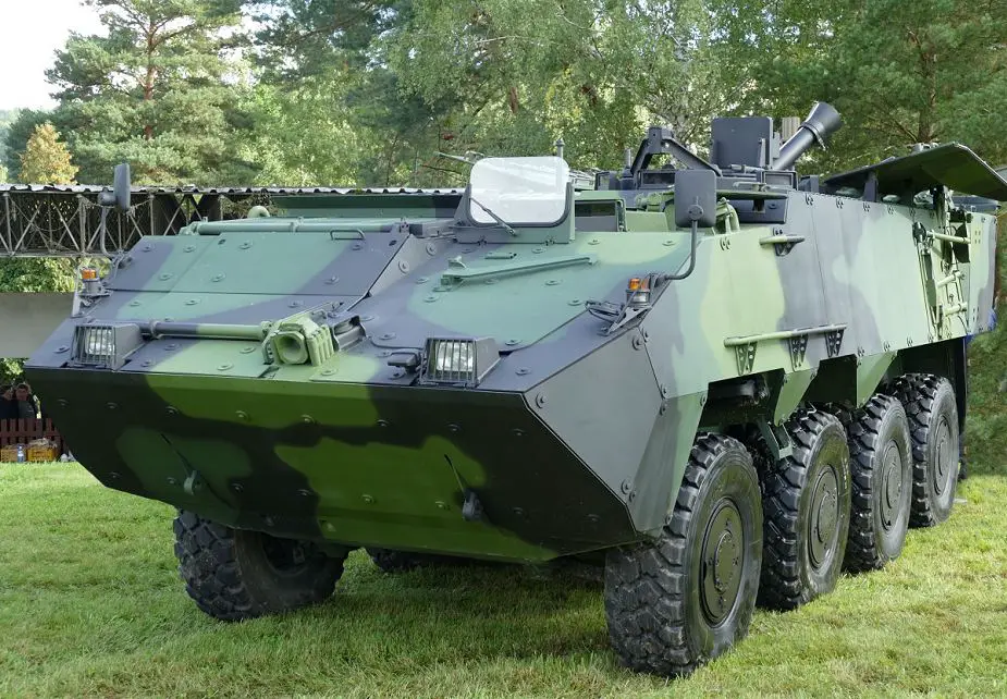

Tatra Defence Vehicle has presented a self-propelled mortar vehicle, a new variant in the Pandur II CZ 8x8 armoured vehicle family. Tatra has developed this vehicle to response to a new request of the Czech army for a fire support vehicle.

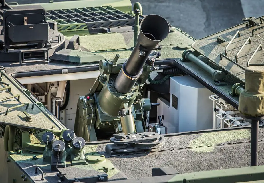

The Pandur II CZ in mortar configuration is fitted with a Soltam Cardom 120 mm caliber mounted at the rear of the vehicle. The Cardom is an autonomous, computerized 120mm recoil mortar system for mounting on light and medium armoured tracked carriers and wheeled armoured vehicles.
The 120mm Soltam Cardom mortar system has a traverse of 360°, it can fire from inside or from outside of the vehicle. In the vehicle, it fires through tow roof hatches, that open on each side of the vehicle.
It has a maximum firing range of 6,800 meters with a rate of intense fire is 16 rounds per minute, however rate of sustained fire. A first round can be fired within 30 seconds from travelling. A total of 50 rounds of ammunition are stored inside the vehicle.
