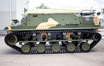

Niin vissiin tämä:Muistuttaa melkoisen paljon sitä Ukrainalaisten tuhoamaa arktista venäläistä vaunua muutaman päivän takaa.
Taitaa olla jonkunlainen teka, sopii kuljetuksiin muttei varsinainen etulinjan laite.
Sopii taksiksi, kuten 6x6, vaikeampana maastoon.Taitaa olla jonkunlainen teka, sopii kuljetuksiin muttei varsinainen etulinjan laite

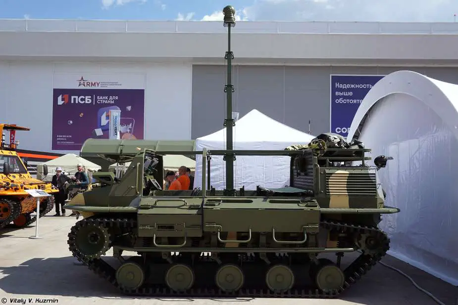

What is "Plastun-SN" - Characteristics
weight - 3.8 tonnes
track width - 500 mm
ground clearance - 500 mm;
cruising speed - 30 km / h;
maximum speed - 50 km / h;
troop - up to 8 persons while travelling on land and up to 6 persons while overcoming water obstacles.
"Plastun-SN" is based on the civilian all-terrain vehicle of the same name "Plastun", which the occupants adapt for military needs. The vehicle can also be used to evacuate the wounded.
				Tuossa vähän speksejä.
AFU Destroy Rare Russian Light Tank For First Time
What is the peculiarity of this vehicle, of which the Russians have only 14 pieces?charter97.org
https://www.armyrecognition.com/def..._plastun-sn_armored_all-terrain_vehicles.htmlThe Plastun-SN tracked vehicle is powered by a Lada 1.6-liter petrol engine, generating 106 horsepower and 148 Nm of torque, allowing for a top speed of 50 km/h, with a recommended speed of 30 km/h. The vehicle features a 5-speed manual transmission, a specific ground pressure of 0.118 kg/cm², and a fuel capacity of 135 liters. These vehicles can accommodate up to eight people on the ground, or up to six when afloat, depending on the variant. The Plastun has a ground clearance of 500 mm and a track width of 500 mm.
Weighing in at 3,800 kg, these tracked all-terrain vehicles are capable of overcoming various obstacles, including ditches up to 30°, trenches up to 1 meter wide, side slopes up to 30°, climbing uphill at over 40°, descending slopes at up to 45°, and they are amphibious, allowing them to traverse water obstacles.
