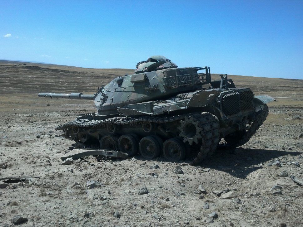

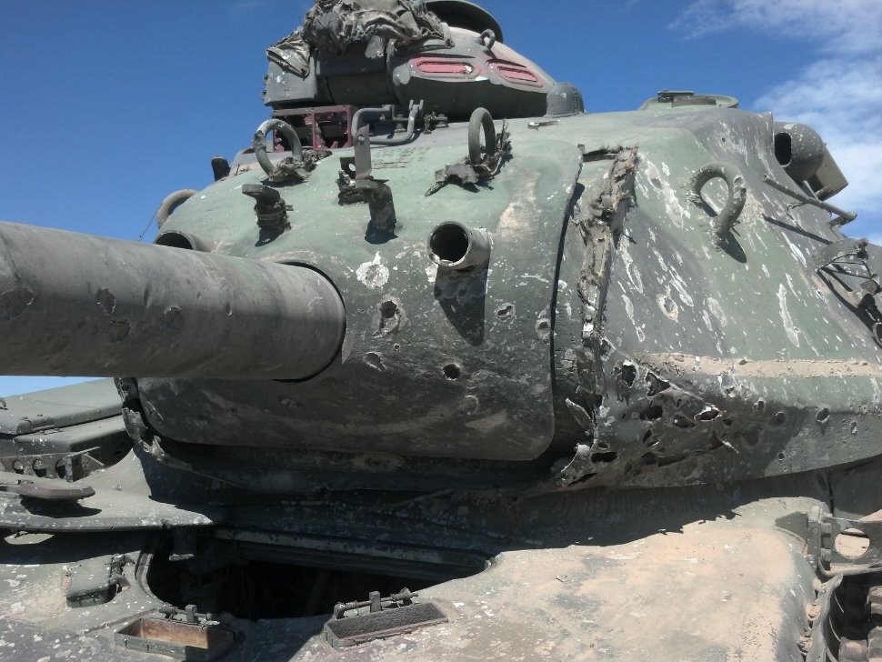

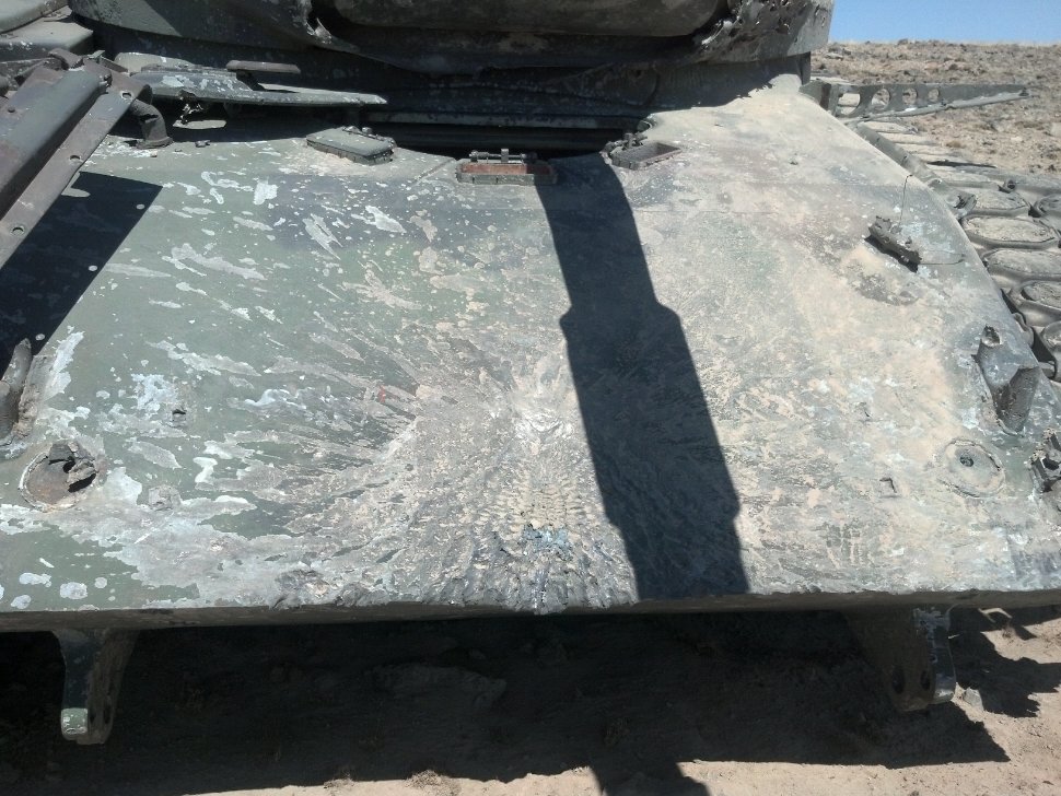

Can a 155mm HE shell destroy an MBT with a direct hit in the front?
7 Answers
Edric Chang, Tank enthusiast
Updated Jul 11, 2017
Here is a pagewith photos of a Main Battle Tank, the M60A3, that got hit by a 155 mm HE artillery shell.
Here are the photos:
Direct hit on front hull. No penetration, but that’s gonna be a pain to scrub off.
You can see all the shrapnel just blast onto the turret. While this tank looks to be on a practice range, it shows its best to keep the driver’s hatch closed when this happens!
Looks like tracks and suspension wheels got blown off from the blast.
So it is clear that an 155 mm HE shell straight onto a MBT, even a 1960s design, is not going to end well for the tank’s integrity. You’ll definitely be dealing with broken tracks, suspensions, and whole bunch of modules. However, the images doesn’t show some factor, like the spalling effect inside the tank from the impact, the effect of the shockwave from the rounds, and whether or not the crew inside would be affected or not.
Either way, the tank looks to be intact, but out of commission regardless. A very understandable situation for any tank hit by a 155 mm HE shell.
Edit: It appears that the info presented by page source is disputable in the true nature of the impacts shown on the picture. Fact is that the tank appears to be on a shooting range and the damages could have been done by a number of smaller anti-tank weapons, even 40 mm grenade launchers. There are other details in the images that do not correlate with the damages a 155 mm HE could do in real life, such as a bent gun tube if a 155 mm truly landed on the front glacis. I would refer to the comments under Kenneth Reese and Bradley Alexander for more details on certain discrepancies.
