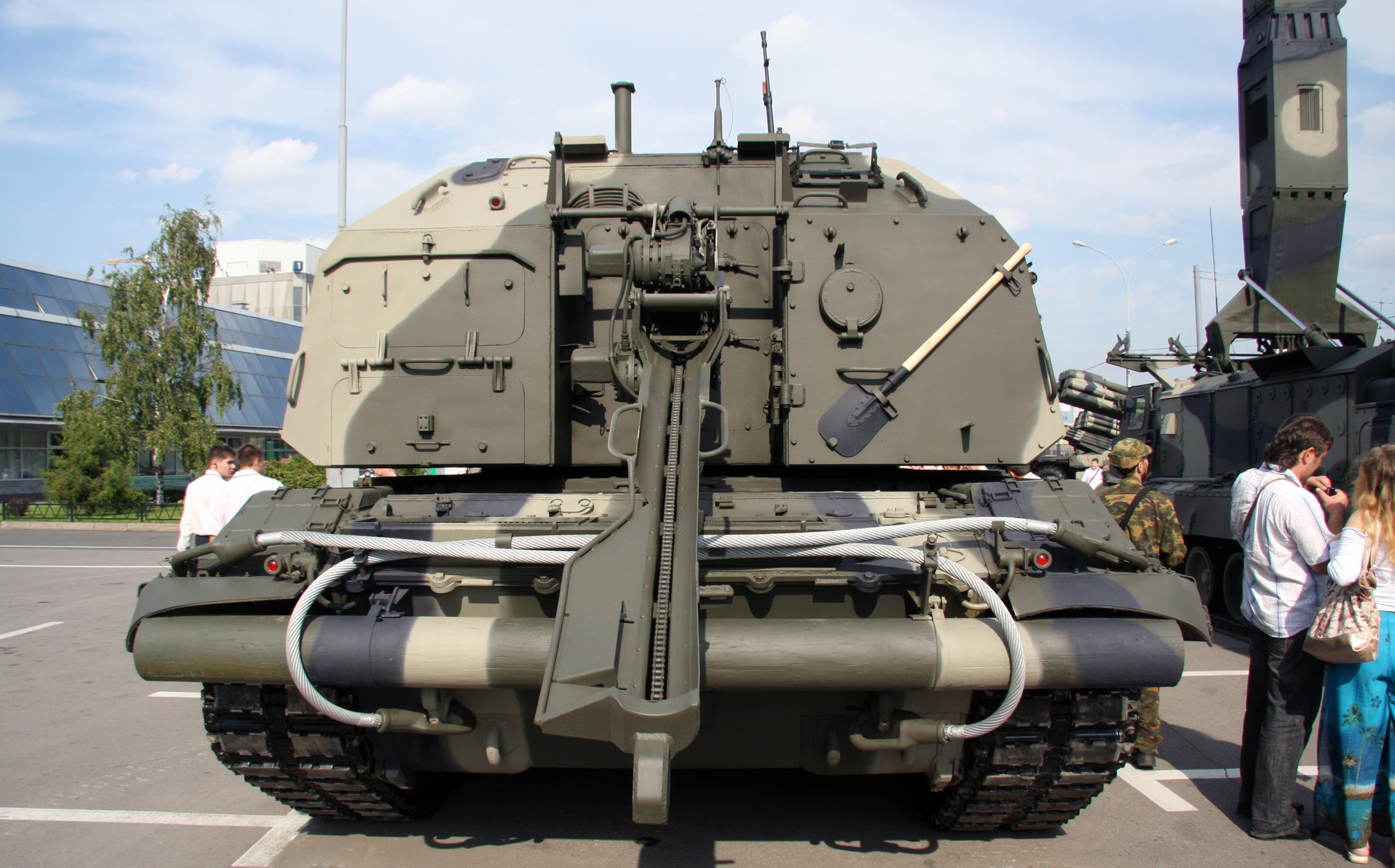

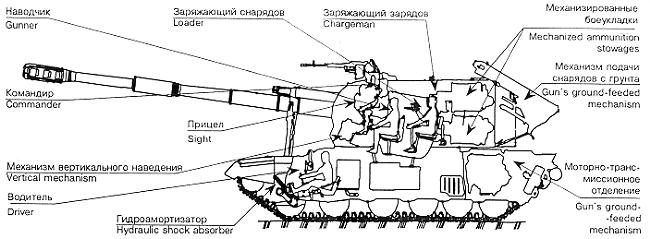

2S19 Msta
550
2S19 and 2S19M1, 108 2S19M2 since 2014.
Tuo M2-versio: Improved version equipped with a new automatic fire control system which increases the rate of fire. Digital electronic maps are now available which significantly speeds up the terrain orientation in difficult geographical conditions and allows performing faster and more efficiently firing missions.
  • Range:
    • 29 km (18 mi) base-bleed
    • 36 km (22 mi) rocket-assisted
  • Rate of fire: 6-8 rounds per minute
  • Weapon elevation: -4° to +68°
  • Weapon traverse: 360°
  • Deployment time: 22 minutes
  • Unit of fire: 50 rounds
  • Crew
    5 soldiers
  • Armor The hull and turret is of all-welded steel armour, protection from small arms fire, shell splinters and
    mines.
  • Weight 42,000 kg
  • Speed 60 km/h on road
  • Range 500 km
  • Dimensions Length, 7,15 m; Width, 3,38 m; Height, 2,99 m
https://en.wikipedia.org/wiki/2S19_Msta
http://www.armyrecognition.com/russ...t_specifications_information_description.html
Kiinnostavaa muuten, että alusta perustuu T-80:een, mutta dieselmoottori on T-72:sta. Onkohan ne muuttaneet mainittuja tankkeja samalla tavalla?
