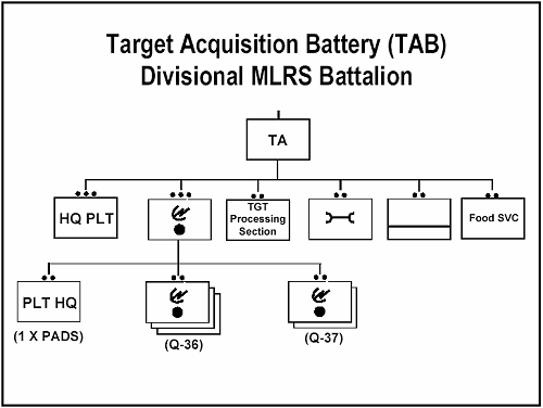

Noin voisi kuvitella. Mutta niitä heittimiä on ollut aika erilaisissa kokoonpanoissa. Tämän yhden perusteella patteristossa (battalion) on 18 heitintä jaettuna kolmeen patteriin (battery).
DIVISIONAL MLRS TARGET ACQUISITION BATTERY​
The Divisional MLRS battalion TAB is organic to the heavy division MLRS battalion. The divisional MLRS battalion is organized with a headquarters, headquarters and service battery (HHS), three six-launcher MLRS firing batteries and a TAB. The functions of the divisional MLRS battalion TAB are the same as for the heavy division TAB. The differences are the organizational structure and the parent headquarters. Unlike the heavy division TAB, this organization does not have a separate survey platoon. It only has a single survey section that is part of target acquisition platoon (TAP) headquarters. Further, the target processing section only has five personnel (see Table 2-2). Figure 2-2 shows the organizational structure.
Table 2-2. Division MLRS Battalion TAB Processing Section
Target Processing Section
TITLEMOSRANKNUMBER
Asst Counterfire Officer131A0CW21
Senior FA Targeting NCO13RSFC1
Targeting NCO13FSSG1
Targeting Processing SP13FSPC1
Targeting Processing SP13FPFC1
TOTAL
5
Figure 2-2. Divisional MLRS Battalion Target Acquisition Battery
Tämä taas kertoo patteristoksi 27 heitintä jaettuna kolmeen 9 heittimen patteriin.
