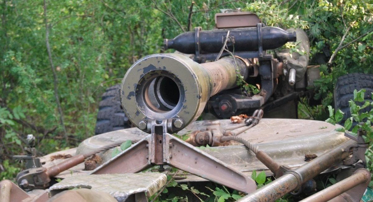

Ukraine_develops_locale-made_artillery_system_using_MTLB_tracked_armored_with_MT-12_100mm_anti-tank_gun_925_001.jpg
The Ukrainian army has published a video on Social Network showing the new development of a mobile artillery system based on a Soviet-made MT-LB multirole tracked armored vehicle fitted with an MT-12 100mm anti-tank towed gun.
