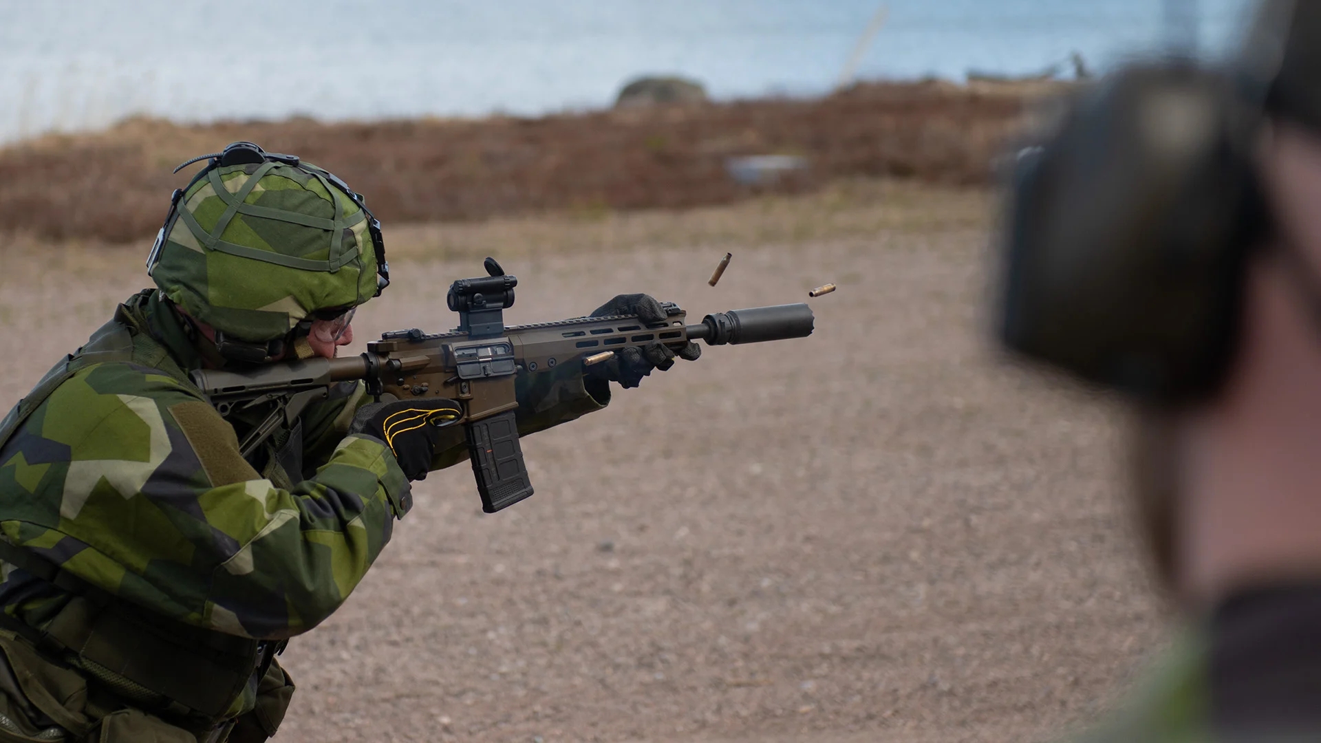

This was also supported by a brief report by Twitter username @VerkanUnderline of the Swedish Air Force who shot the weapon at a recent TTS (‘SRA but in Swedish’) meet. He noted that the weapon is very forgiving and the aimpoint stays the same regardless of support and shooting stance, and that while the recoil unsurprisingly is rather fierce compared to a medium-length DI-gun, the speed of the impulse means that with practice it is possible to regain the target “rather quickly”. The ambidextrous control also garnered praise, and in general he was very happy with it.
