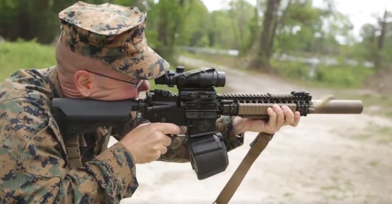

Last week, the Marine Corps Systems Command (MARCORSYSCOM) issued a Sources Sought Notice, often also referred to a Request For Information (RFI) to industry for commerically available suppressors for the 5.56mm NATO M4, M4A1, and M27. The RFI is an important step in developing a realistic requirement which leads to a solicitation and eventually, procurement.
Marine Gunner Christian Wade (seen above) has been a big advocate of suppressing Marine weapons, even producing videos to educate Marines of their true capabilities. It’s good to see the Marines catching up with his vision.
They’ve certainly done their homework and have developed quite a list of what they are looking for. Additionally, they are keeping their options open, stating that future procurement quantities of suppressors could span between 18,000 and 194,000.
