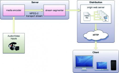

Figure represents the generic flow of transmissions and reception of audio streaming over internet. The streaming transport protocol can work at many different transmission rates in order to allow the client to choose the best rate according with the speed of the connections it is wired to. In this project we considered two different types of “human” interface”. The first is based on the LCD shield. The second is a web based interface. On the LCD shield five push buttons allow setting the radio by application menu functions as like as browsing radio station and audio tracks or setting up the volume.

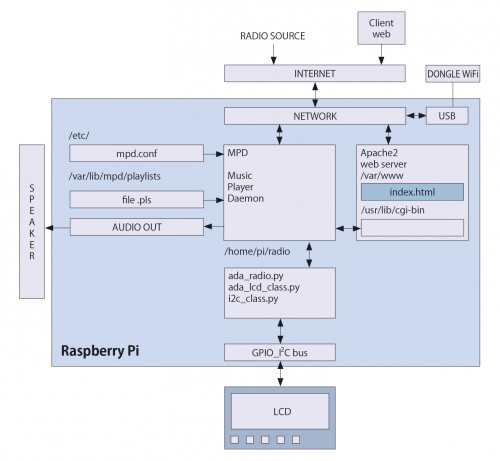

The figure shows the application block diagram we are going to set up. Tanks to the effort of Bob Rathbone and Adafruit Industries, both expert in building and delivering products and expertise on Raspberry Pi, that have delivered many useful software tools and application to the community under the GNU GPL licence, we can adopt in our project, many “ready to use” software “bricks”. Actually, to complete the project, it is just required to physically assembly and install the LCD shield, the WiFi dongle and to download and configure the software. No programming it is required. The core module of the whole project is the MPD software. MPD stays for Music Player Daemon, that is a software server aimed to play audio streaming and files. It has been written to run on old pc powered by Pentium 75 processors. The main purpose of this software is using as less system resources as possible, while being able to perform gapless playback, output audio buffering and cross fading. This features and the availability of the package for the Debian distribution make it the ideal tool to be installed on Raspberry Pi. Moreover MPD developers have kept a clear separation between server and client side of the tool. This leave the user free to choose which user interfaces adopt to manage his proper sound box, among the many available. On the web we can get a variety of clients with different interfaces like command line, stand alone GUI and web oriented applications, compatible with different device types like PC, tablet, smartphones, etc. You can find a list of available clients at the addresshttp://mpd.wikia.com/wiki/Clients
You can go trough and try many of them. In this project we are going to install the solution developed basically for Raspberry Pi by Bob Rathbone (thanks!), from a fork of the Snoopy MPD client.
