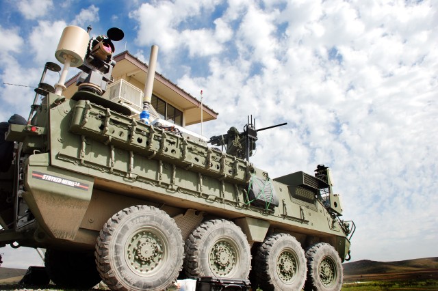

1 / 3 Show Caption + A 5-kilowatt laser sits on a Stryker armored vehicles called the Mobile Expeditionary High Enegry Laser or MEHEL, during the Maneuver Fires Integrated Experiment, or MFIX, at Fort Sill, Okla., April 5, 2017. (Photo Credit: Monica K. Guthrie ) VIEW ORIGINAL

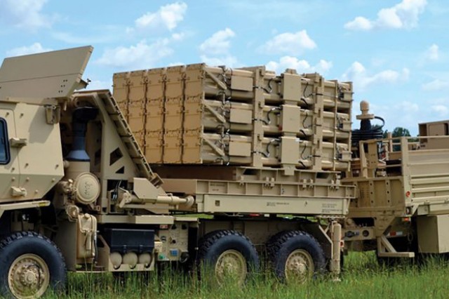

2 / 3 Show Caption + The Multi-Mission Launcher or MML is mounted on the bed of a medium tactical vehicle as part of the Indirect Fire Protection Capability, or IFPC demonstrator. (Photo Credit: PEO Missiles and Space) VIEW ORIGINAL

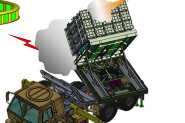

3 / 3 Show Caption + Artist's rendering of the Multi Mission Launcher of the Indirect Fire Protection Capability Increment 2 -Intercept, or IFPC Increment 2-I, firing an interceptor missile. (Photo Credit: U.S. Army Acquisition Support Center) VIEW ORIGINAL

One such system being developed is the Indirect Fire Protection Capability Increment 2-Intercept.
IFPC INCREMENT 2-I
The IFPC is a mobile, ground-based system specifically designed to defeat UAS and cruise missiles, along with mortars, artillery and rockets. The Block 1 system uses an existing interceptor and sensor along with a new Multi-Mission Launcher, or MML, mounted on a medium tactical vehicle. The launcher, which entered a demonstration phase in 2015, can rotate 360 degrees in order to shoot down UAS or cruise missiles incoming from any direction.
The Army has already selected one interceptor for the system, the AIM-9X Sidewinder missile. It has also experimented with a number of other interceptor missiles since the MML will be able to handle multiple types in its 15 tubes.
The Expanded Mission Area Missile, or EMAM, will be what the Army calls the next interceptor selected for the IFPC. Plans call for the missile manufacturer to be selected next fiscal year and EMAM will be used with the IFPC Block 2 system.
The Army is also experimenting with directed energy or lasers on the IFPC to shoot down drones.
HIGH-ENERGY LASERS
"I will tell you that we're getting awful close" to developing a viable high-energy laser weapon, said Richard P. DeFatta, director, Future Warfare Center, U.S. Army Space and Missile Defense Command.
The High-Energy Laser Tactical Vehicle Demonstrator will put 100 kilowatts of energy into the same vehicle being used for the IPFC, DeFatta said. The laser cannot yet be fired from one of the same tubes already on the IPFC launcher, but DeFatta said that's what some officials would like to see.
This year, SMDC integrated a 60kW laser into a Heavy Expanded Mobility Tactical Truck or HEMTT, and DeFatta said that's never been done before.
"We've never had that much energy out of a fiber-laser system -- a solid-state laser system --- on a ground vehicle that you can roll around and actually engage," he said, explaining that's a significant "knowledge point" moving forward to the 100kW.
"More power means less dwell time on a target," he said. "If you want to engage more targets, you (need) higher power."
SMDC is also experimenting with a 50kW laser in a Stryker-sized vehicle, he said.
The next step is to teach Soldiers how to use such lasers, he said, so a low-power laser, a 5kW has been put on a Stryker as a technology demonstrator called the Mobile-Experimental High-Energy Laser. The MEHEL was fired last year by Soldiers at Fort Sill, Oklahoma. Today, the MEHEL is in Europe, DeFatta said.
There are still some challenges with the laser program that need to be overcome, DeFatta said. For instance, some naysayers point out that a laser can't be fired successfully in a 100-mph sandstorm.
"That's true," he said, "but what are you shooting at in a 100-mile-per-hour sandstorm?"
Some other myths about lasers have been disproven, DeFatta said. SMDC has shown that a laser can be successfully fired in a rainstorm, for instance, though he said any degraded atmosphere requires more laser power.
