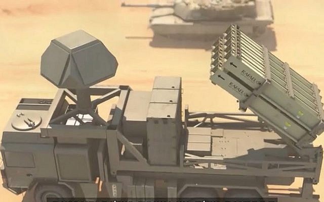

Nyt Iron Dome on myös pyörillä. USA kiinnostunut.
Israel unveils portable Iron Dome at Paris air show
Aerospace company Rafael says new I-Dome is an ‘all-in-one’ truck-mounted aerial defense battery; US military reportedly interested The I-Dome, a portable version of the Iron Dome missile defense system, made by Israeli aerospace company Rafael. (screen capture: Channel 13/Rafael)
The I-Dome, a portable version of the Iron Dome missile defense system, made by Israeli aerospace company Rafael. (screen capture: Channel 13/Rafael) Israeli aerospace company Rafael has unveiled a portable Iron Dome missile defense battery, promising deployed troops the same protection the original system provided for civilian populations.
The I-Dome, designed to protect troops from rockets, mortars and UAV attacks, was among several new Israeli-made weapons systems featured this week at the Paris Air Show.
The scaled-down missile battery fits on the back of a large flatbed truck, making the system easily transportable. Its cartridge holds 10 Tamir interceptor misses, instead of the 20 used by its larger Iron Dome counterpart.
“Basically, we put a missile launcher, radar and a control system in the cab of a vehicle,” Rafael CEO Pini Yungman told Channel 13 from the Paris expo. “This array can offer the same protection as the Iron Dome battery.”
“The I-Dome is an all-in-one system,” he said.

According to Channel 13, the US military has also expressed interest in purchasing several portable I-Dome batteries from Israel.
