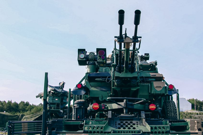

Puola vastaanottanut viimeiset tilaamansa modernisoidut Sergeit:
Poland has received the last of 6 Pilica VSHORAD batteries ordered in 2016.
A Pilica battery consists of
-6 ZUR-23-2SP
-6 transport vehicles for the ZUR-23-2SP
-1 SRL-97 Radar
-1 command post
-2 resupply vehicles
https://grupapgz.pl/wszystkie-zestawy-pilica-przekazane-wojsku-polskiemu/
The ZUR-23-2SP is a heavily upgraded ZU-23-2 equipped with the GOS-1 EOTS which houses a day sight, laser range finder and KMW-1 Teja thermal sight. armament consists of 2 23mm cannon and 2 Grom or Piorun MANPADS.
All Pilica sets donated to the Polish Army
On November 30, the companies of the Polish Armaments Group constituting the PGZ-PILICA Consortium completed further deliveries of serial PILICA Anti-Aircraft Missile and Artillery Systems (delivery of the 4th, 5th and 6th system, i.e. the prototype after adaptation to series production). Thus, all very short-range air defense systems (VSHORAD) ordered in November 2016 have been delivered to the army.
The PILICA missile and artillery system is one of the most important very short-range air defense systems. The foundation of the Polish anti-aircraft defense system. ZM Tarnów is its integrator as part of the established consortium - says Henryk Łabędź, President of the Management Board of ZM Tarnów.
As part of the deliveries, the Polish army received a total of 6 systems. A single PSR-A PILICA set includes: 6 fire units with artillery tractors, command post, radar station; 2 transport vehicles and 2 ammunition vehicles.
This is one of the key projects, independently carried out based on national production capabilities, which is also important from the point of view of Poland's defense capabilities. Importantly, the delivered PILICA sets, thanks to their integration into the system, are much more effective and efficient in combating air attack means than a single ZU-23-2 cannon.
– PSR-A PILICA is one of the basic elements of the lowest layer of a multi-layer, integrated air defense system built for the needs of the Polish Armed Forces. The layer, which is worth emphasizing, is created exclusively from elements produced by Polish industry. It is a very modern and constantly developing system that receives good reviews from users, i.e. soldiers who operate PSR-A PILICA on a daily basis. It is also an example of good cooperation and optimal use of the potential we have within the Polish Armaments Group. PILICA provided the basis for creating another solution, PILICA+, which has already been concluded in the form of a long-term contract - emphasizes Sebastian Chwałek, President of the Management Board of PGZ SA.
The PILICA system will be developed to the PILICA+ level so that the Polish Armed Forces have more and more advanced and effective equipment effective both in the short and very short range of anti-aircraft and anti-missile defense. This is confirmed by another executive contract signed in 2023 for the supply of 22 PILICA Anti-Aircraft Missile and Artillery Systems , which are one of the key elements of the Pilica+ Missile and Artillery Sets (ZRA) for the needs of the Polish Armed Forces.
The contract covers: 16 new ones (including one training unit for the Air Force Training Center) and 6 already manufactured units, which will be supplemented with new elements to the PILICA+ standard.
The contractor of the PILICA Anti-Aircraft Missile and Artillery System is the PGZ-PILICA Consortium, which consists of companies of the PGZ Capital Group: PGZ SA, PIT-RADWAR SA, PCO SA and Zakłady Mechaniczne Tarnów SA, as the system integrator.

Fire control is handled by the command post through remote control of the firing unit. LÄHDE
Also ZUR-23-2SP can be used remote controlled LÄHDE
Näin Ukrainan sodan arkea seuratessa, ei voi olla pohtimatta, onko tällaiselle järjestelmälle tarvetta Suomessakin.
Hinta, hinta ja hinta - tästä on tietysti aina pohjimmiltaan kyse.
Olisipa mielenkiintoista nähdä muutama tällainen järjestelmä kenttätesteissä Ukrainassa. Kyky torjua Shahed-136/131 droneja ja risteilyohjuksia on se mikä erityisesti kiinnostaa.
