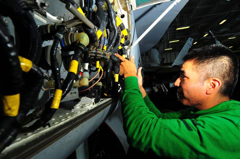

Hornetin hydrauliikkajärjestelmää täytettiin ja säädettiin lennossa. Drakenin hydrauliikkajärjestelmä oli tosiaan todella suuritöinen siihen verrattuna.
Samoin Hornetissa on obogs.
F-35 tulee olemaan jännittävä vertaillessa entisiin hydraulisiin huollon osalta.
EMALSin väitetään vähentävän huoltoaikaa ratkaisevasti, mutta jää nähtäväksi miten toteutuu käytännössä.
Perinteinen systeemihän on siinä enää laskutelineen ja nokkapyörän osalta.
"They greatly simplified the hydraulic systems because everything is self-contained. You’ve got your own hydraulic systems. You got your own actuators.
If you were to compare the F-35 to the F-16, you probably reduced maintenance by 60%. When you have self-sustained systems, and when that system breaks, you just got to change that one component and you’re done, that’s it. Before you had to remove the lines, you got brake lines and now you just got an actuator you pull and you remove and you install a new one." http://www.sldinfo.com/a-conversati...-the-new-f-35-actuator-system-on-maintenance/

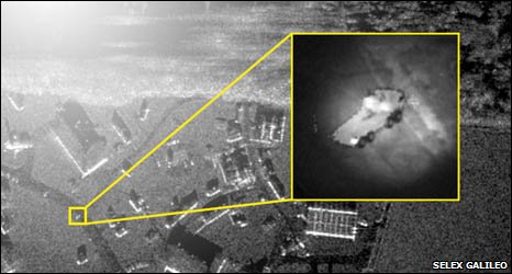

Internetsoturi jo hyvin vastasikin. Täydennän vielä vähän Aesa-tutkan näkökulmasta.
http://aviationintel.com/the-great-radar-race-aesa-development-in-high-gear/
The power and focusing ability of the AESA radar has made noncooperative target recognition much easier that the past. Although this is highly guarded technology it is reasonable to assume that an AESA radar can take a synthetic aperture radar “image” of its target to compare to a database of 3D vehicle models and thus classify the exact type being targeted along with displaying the % of certainty at the time of interrogation and classification. It can also use the less comprehensive method of counting the blades on the engine face of aircraft that has seem to have been the legacy method over the past couple decades with greater certainty. It may even be possible to tell the exact load out of the enemy aircraft in question via high-resolution radar imaging with a robust software database for the system to compare the radar image to. This is amazing and relevant technology as “Blue on Blue” friendly fire incidents have become politically unacceptable in the modern-day of coalition lead operations. Furthermore, knowing the exact identity, and thus capabilities of the threat you face at long ranges is a massive tactical advantage in aerial warfare.
http://www.pakistanaffairs.pk/threads/69741-Is-Pakistan-Flying-Picosar
Tässä vielä esitys, jonka lopussa mm. asiaa kuvataan.
http://www.slideshare.net/aticourses/aesa-airborne-radartheoryandoperationscoursesampler
aesa-airborne-radar-theory-and-operations-technical-training-course-sampler-31-638.jpg

Tutkajärjestelmät pystyivät kyllä ilmoittamaan IFF-tunnisteesta jo 60-luvulta lähtien, tosin kyseessä oli erillinen järjestelmä (SRZO) joka oli linkitetty hävittäjän tutkaan näyttäen tutkassa näkyvät kohteet tunnistettuina tai tuntemattomina parin sekunnin ajan kyselynappia painaessa. Ongelmia oli tosin monta kappaletta, mm: kohteen oli pakko näkyä tutkassa jotta tunniste voidaan tehdä, Häirinnän ja luonnollisen taustakohinan muodostamat ongelmat kohteen havaitsemisessa ja tunnisteessa (häirintää tai silppua lähettävä/pudottava kohde oli mahdotonta tunnistaa).
Moderneissa koneissa tuo tutkan muodostama kuva vs. tietopankkiin tallennettu kuva, sekä muut tunnisteet voivat olla tapoja tunnistaa koneita, mutta kiva olisi tietää tapahtuuko tämä 80km päässä olevasta kohteesta, 50km päässä olevasta kohteesta (C-7 mallin amraamin arvioitu kantama) vaiko 20km päässä olevasta kohteesta (modernien IP-ohjusten arvioitu maksimikantama) Entä tarviiko kohteen olla kohti-tai poispäin lentävä, tai sivusuunnassa liikkuva Entä mahdollinen taajuushäirintä, silputus tai muu taustakohina? Sama pätee osaltaan myös muihin optisiin järjestelmiin. Esimerkiksi IRST-järjestelmä täysin passiivisena ei anna mitään tietoa kohdekoneesta, kuin sen sijainnin ja liikesuunnan, IFF, tunnisteen tekemiseksi tarvitaan erillisen IFF-laitteiston tai tutkan antama kysely jotta IRST-järjestelmällä löydetty kohde voidaan luokitella. EO-laitteisto tietysti on eri, mutta laukaisupäätöksen tekeminen tutkan IFF-järjestelmän sanoessa tuntematon, pohjautuen EO-järjestelmän tai tutkalle alisteisen maalinosoituslaitteen antamaan kuvaan yli 40-50km päässä olevasta kohteesta ei omiin korviini kuulosta kovinkaan varmalta IFF-tunnisteelta.
