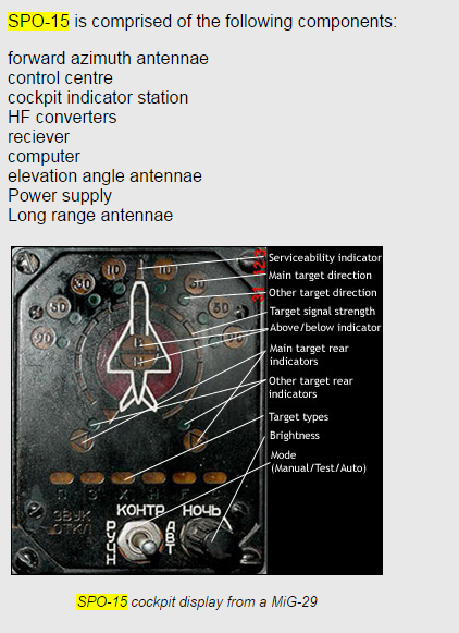

http://aerospace.boopidoo.com/phile...scan's guide to Russian Military Avionics.htm
The outer yellow lights represent the azimuth angle of the most threatening target. The light will remain lit for 8-12 seconds, so a scan rate less than this will result in a permanently lit light. The inner green dots show all other targets. The lights will indicate the approximate direction. If the emitter lies in a direction between two lights both adjacent lights will light up. The six lights across the bottom represents 6 target types which will show the radar type of the most threatening target. The inner ring of yellow indicators light up successively to show the strength of the received signal. As well as the visual indicator, a low pitched sound with similar characteristics to the detected radar signal will be given.
If the hostile radar switches to tracking (STT) the red circle will flash and a continuous high pitched audio tone will sound.
When a SAM launch is detected a continuous variable pitch sound will be given.
The Beryoza is claimed to be capable of detecting enemy airborne radars at 120% of the distance within which the enemy fighter can launch a missile.
Radars operating in TWS mode cannot be distinguished from search mode.
The priority target is simply detirmined by target type- one type is always considered more dangerous than another, regardless of signal strength or other factors.
Bands covered: 4.45-10.35GHz
Direction finding: ±10° (front)
Bandwidth capability: 20Khz
Weight: 25kg

Voi luoja sentään. Se mahdollinen tutkavaroitinjärjestelmä ei ensinnäkään mistään tiedä onko ohjusta ammuttu vai ei ennenkuin ohjus kytkee oman tutkansa päällee muutamaa sekuntia ennen osumaa tosin kun väitit. Mekaanisestikin skannaava perinteinen hävittäjätutka (kuten Hornetin APG-73) käyttää AMRAAM:ia aktiivisena ammuttaessa silloin ihan samaa track-while-scan moodia kuin silloinkun ohjus ei ole lennossa.
Toisekseen, tuo 70-luvun SPO-15 (joka tietysti on yleisin itänaapurin alkeellisista tutkavaroitinjärjestelmistä) ei edes erota track-while-scan moodia perus scan moodista.
Kolmannekseen, tuolla ikivanhalla analogis-digitaalisella systeemillä ei ole mitään mahdollisuutta edes havaita APG-81:n tyyppisen LPI tutkan seurantaa. Ei kertakaikkiaan mitään mahdollisuutta!
