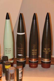

Nexter Munitions 155mm projectile family includes, from left to right, smoke (LU 217), Illuminating (LU 215), HE (LU 211) and HE Insensitive Munition (LU 211 IM).

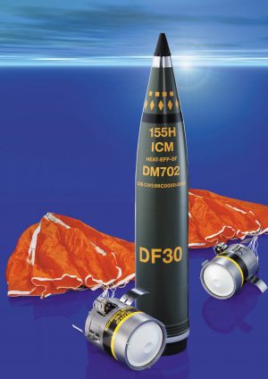

German 155mm DM702 SMArt artillery projectile carries two sub-munitions with an advanced warhead designed to defeat the upper surfaces of armoured vehicles.

The 155mm SMArt was developed by GiWS, a joint venture company between Rheinmetall and Diehl and contains two sub-munitions with an Explosively Formed Projectile (EFP) warhead to penetrate the top of AFV.
Production was undertaken for Germany followed by Austria, Greece and Switzerland. Although production was completed it is likely to start again as the early shells for Germany are running out of shelf life.

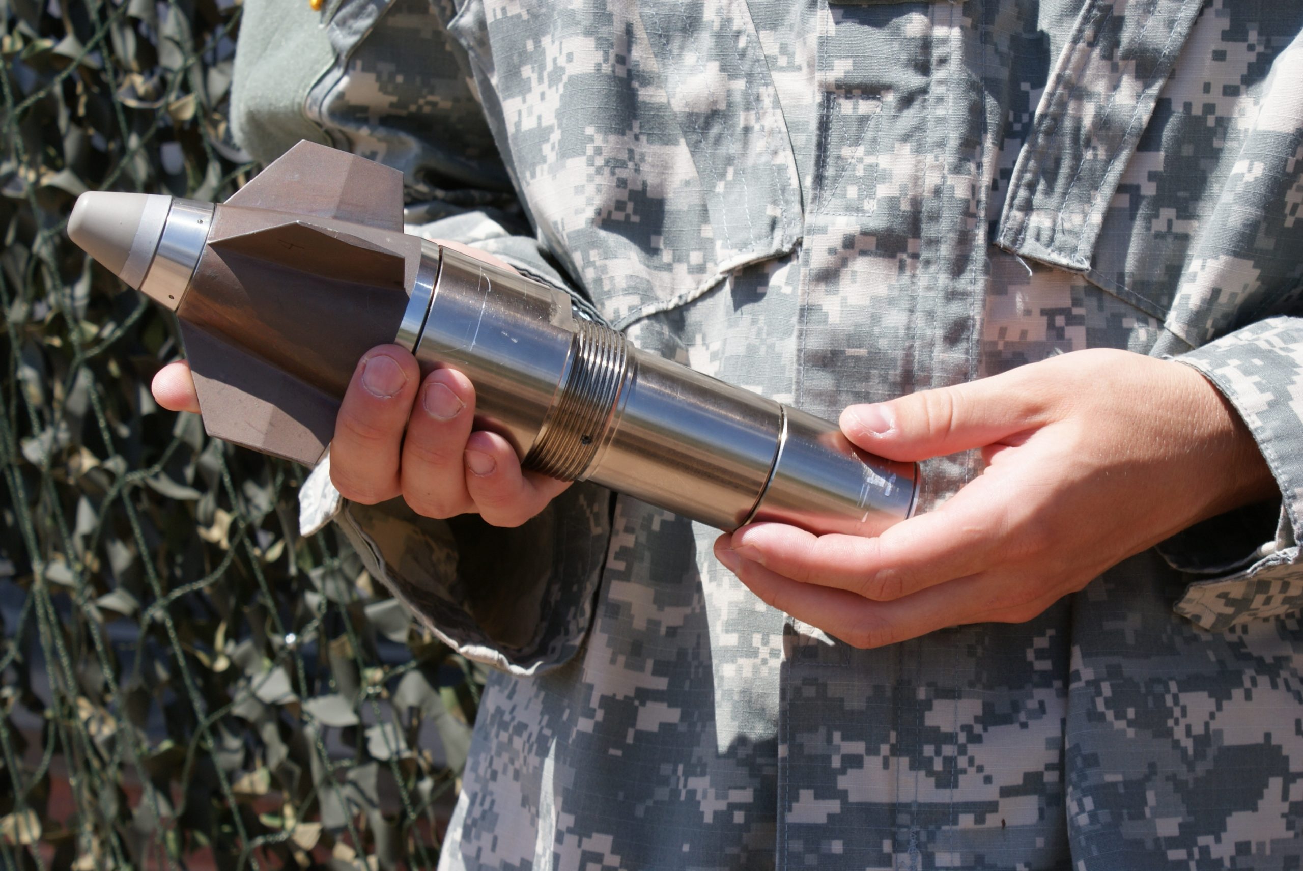

US Army has fielded the Northrop Grumman M1156 Precision Guidance Kit (PGK) which is a direct replacement for a standard artillery fuze. It contains GPS guidance using fuzing functions and an integrated GPS receiver to correct the inherent errors associated with a ballistic firing solution. This increases accuracy and reduces the number of projectiles required to neutralise the target so reducing the logistic chain.
This is used with the US 155mm M795 and M549A1 HE projectiles with mission critical data being loaded into the PGK using the Enhanced Portable Inductive Artillery Fuze Setter.
By April 2020 over 50,000 PGK had been produced and export sales made to Australia and Canada. Test firing had been conducted with a number of other artillery systems including the German PzH 2000. This fired a Rheinmetall DM111 HE projectile out to a range of 27km with all 10 rounds landing within five metres of the target.
There are other course correction systems including the Nexter Systems Spacido and the Top Gun from Israel Aircraft Industries IAI) which has been adopted by the Israel Defense Force for its 155mm artillery projectiles.
Northrop Grumman M1156 Precision Guidance Kit (PGK) is a direct replacement for a standard artillery fuze and provides a step change in accuracy.
