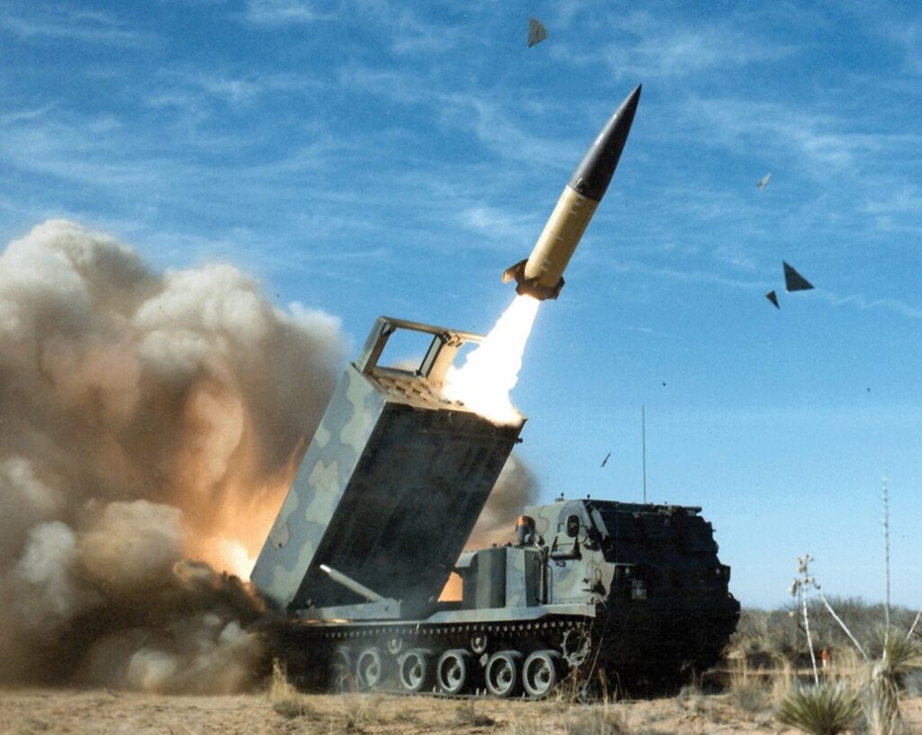

Tuossa juttua tuosta atacmsista:
Carter, Roper Unveil Army’s New Ship-Killer Missile: ATACMS Upgrade
By SYDNEY J. FREEDBERG JR.on October 28, 2016 at 11:30 AM
Army ATACMS missile launch.
UPDATED with William Roper comments WASHINGTON: The Army’s long-range artillery rocket, ATACMS, will get upgraded to strike moving targets on land and at sea, Defense Secretary Ashton Carter announced today. After at least two years of pressure from Congress and vague promises from Pentagon leaders, and for the first time since the Coastal Artillery Corps was disbanded 66 years ago, the Army is officially back in the business of killing ships. That gives the largest service a big new role in counteringRussian aggression in the Baltic and Black Seas or defending allies like the Philippinesagainst China.

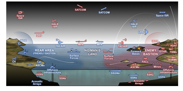

But why does the Army need to sink ships, anyway? Don’t we have a Navy for that? The answer lies in evolving concepts like Multi-Domain Battle and the Third Offset Strategy, the topic of today’s CSIS conference. In essence, 25 years after the stunning debut of stealth, smart weapons, and GPS in the First Gulf War, potential adversaries have not only copied most of those technologies but woven them together into complex, layered defenses designed to keep US forces at bay — so-called Anti-Access/Area Denial (A2/AD) systems. In particular, both China and Russia have invested heavily in long-range missiles, and the requisite sensors and command networks, that are based on land but can shoot down US aircraft high in the air or sink US ships well out at sea. (The most notorious example is the Chinese DF-21 anti-ship ballistic missile, nicknamed the “carrier killer.”)
In such a lethal war zone, land-based missile batteries have one huge advantage: They can’t sink. That’s something our enemies have exploited for years. Now the US military will seize that advantage for itself.
