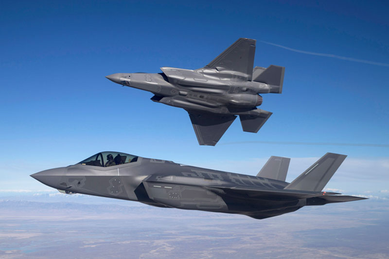

"RWR/ESM part has coverage 2-6GHz (Band 3), 6-18GHz (Band 4) as a base and adds 0.5-2Ghz (Band 2) and 18-40Ghz (Band 5) for Block 4. "
The aircraft has radar warning receivers on the leading edge of its wings covering frequencies of bands 2, 3 and 4. Two band-3/4 RWRs are positioned close to the wingtips on the aft wing trailing edges and on the aft horizontal stabilisers, with additional RWRs covering band 2 either side of the aircraft’s exhaust. These provide the aircraft with full 360 degree coverage.
Although the aircraft is presently configured to detect RF emissions in bands 2, 3 and 4, there is growth potential for this to encompass band-5 threats in the future. Although no details appear to have been publicly released it is thought that the AN/ASQ-239 can detect hostile radars transmitting in a two gigahertz to 20GHz waveband. Enhancements to the AN/ASQ-239 are being performed via a series of block enhancements which confer increasing levels of capability onto the self-protection system.

the EW antennae on F-22 only consist of band 3 and band 4 array, but that is enough for ALR-94 to cover the frequency range from 0.5-18 GHz so logically the band 2 EW antennae of ASQ-239 will be used to geolocate radar with lower frequency.
