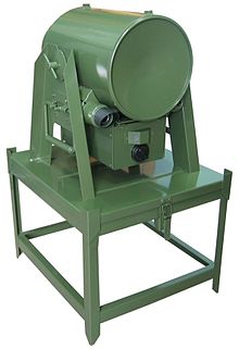

https://en.wikipedia.org/wiki/MPB_mineMPB mine
From Wikipedia, the free encyclopedia
Polish off-route anti tank mine MPB-ZN
The MPB is a Polish off-route anti-tank mine. It was developed by BELMA (BZE BELMA S.A.) with its partner Military Institute of Engineer Technology. The MPB consists of a metal cylinder filled with explosives, mounted horizontally in an adjustable frame. The mine is intended to be hidden from direct view of the intended target, off to the side of a probable vehicle route, usually a road, to attack the weaker armour on the sides and rear of a vehicle. The mine can be triggered by either a contact fuze (MPB-ZK variant) or an influence fuze (MPB-ZN variant) based on infra-red and acoustic sensors, and is also fitted with an anti-handling device. When used with the passive infrared fuze, an acoustic sensor detects approaching vehicles and activates the infra-red sensor, which triggers the mine at an optimal moment as the target passes. The mine can be programmed to self-destruct after either 1, 10 or 30 days have passed.
The mine uses the Misznay–Schardin effect to project an explosively formed projectile to an effective range of roughly 50 meters, where it can penetrate up to 100 millimeters of rolled homogeneous armour (RHA) plate. The energy carried by the projectile is large enough that it can often significantly damage a vehicle that it hits.

http://www.belma.pl/de/militrtechnik/p/444/off-route-antitank-mine-with-influence-fuse-mpb-znThe off-route, anti-vehicle mine MPB-ZN is designed for attacking any combat vehicle, both wheeled and tracked. The mine’s effective attack range is 2-50m for vehicles moving at the speed 5-60km/h. The mine capable is of piercing side parts of combat vehicles:
- tanks with covers and reactive armor – side and rear parts of the hull;
- infantry fighting vehicles, armored transporters and other transport means – any side of vehicle hull.
Using of this mine is provide for supplementing and increasing efficiency of engineering barrier, especially in a places, where using other mines is difficult or unintentional, for example: mining in urban areas, obstructing the access road to areas of expecting redeploying of enemy forces, quickly closing of the passage in minefield and places of expecting crossing through water obstruction. The mine uses large warhead to project a powerful explosively formed projectile (EFP) toward vehicle’s hull, capable of penetrating 100 milimeters of armour at a range of 50 meters. Influence fuse gives the MPB-ZN mine ability to remotely detect of approaching targets by means of acoustic sensors and subsequently causes warhead to detonate when target crosses optic axis of coaxially installed thermal sensor.

Eli tuo ylläoleva möykky räjähtää eri tavalla kuin meidän kylkimiinat.
Kui? Tietääkseni tuo efekti kattaa kaikki ontelopanokset, myös EFP panokset.
netti kirjoitti:Tekniikan tunnetuin sovellutus on ontelopanos, englanniksi hollow (tai shaped) charge. Koska terminologia ei ole vakiintunutta, alan kirjallisuudesa käytetään eri nimityksiä, jotka juontavat juurensa vaikkapa keksijöistä ja kokeilijoista. Sekaannusta lisää se, että ontelopanoksen kartiokulman muuttuessa terävästä tylpäksi, vaikuttava osa muuttuu ontelosuihkusta (jet) iskumassaksi (slug). Jälkimmäinen panos on nimetty ilmeisesti myyvemmällä nimellään "self-forging fragment" (SFF) tai "explosively-formed projectile" (EFP) - suomeksi iskumassapanos. Näiden välillä on vielä puolipallopintainen kartio, josta muodostuu välimuoto. Panoksen vaikutusetäisyys ja -tapa määräytyvät kartion muodon mukaan. Näin ollen riippuu välineen käyttötarkoituksesta, onko kartiokulma terävä, tylppä vai jokin muu. Ontelosuihkuun perustuvista panoksista (kartiokulma terävä), joita käytetään varsinkin pst-aseissa, näkee seuraavia nimityksiä: - RSV III (riktad sprängverkan) - holl~w (shaped) charge - Monroe/Neumann effect - HEAT (High Explosive Anti-Tank, ontelokranaatti). Iskumassaan perustuvista panoksista, joiden kartio on tylppäkulmainen tai esim paraboloidi "lautanen" ja joita käytetään etupäässä miinoissa, näkee seuraavia nimityksiä: - RSV IV - SFF tai EFP - Mizney-Shardin Effect (unkarilaisen ja saksalaisen kehittäjän mukaan) - Plate tai "P" charge. Kartion muodon mukaan iskumassan ja ontelosuihkun suhteellinen osuus ja iskumassan nopeus muuttuvat.
