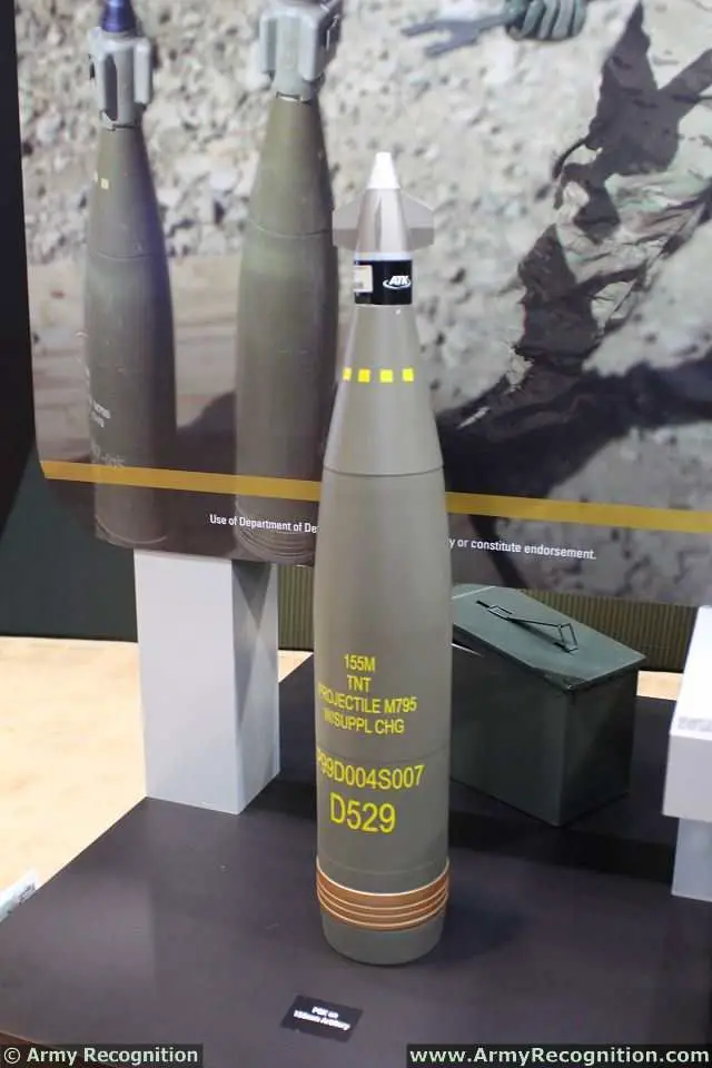

Orbital_ATK_155mm_Artillery_Precision_Guidance_Kit_Meets_All_Requirements_During_Test_640_001.jpg
Orbital ATK announced on June 29 that the U.S. Army's Precision Guidance Kit (PGK) for 155mm artillery achieved another major program milestone, having successfully completed its first production Lot Acceptance Test, demonstrating a median accuracy of less than 10 meters and passing all safety and reliability requirements.
“Extensive, rigorous testing continues to prove the maturity of PGK technology in terms of reliability, performance and safety,” said Dan Olson, vice president and general manager for Orbital ATK’s Armament Systems division of the Defense Systems Group.
Two additional Lot Acceptance Tests will confirm production consistency while also populating a reliability database that provides information which leads to product improvements over the course of production.
“Our precision guidance expertise is making a difference across multiple platforms for our customers,” said Mike Kahn, president, Orbital ATK Defense Systems Group. “Accuracy translates to effectiveness, an important factor in support of the warfighter.”
