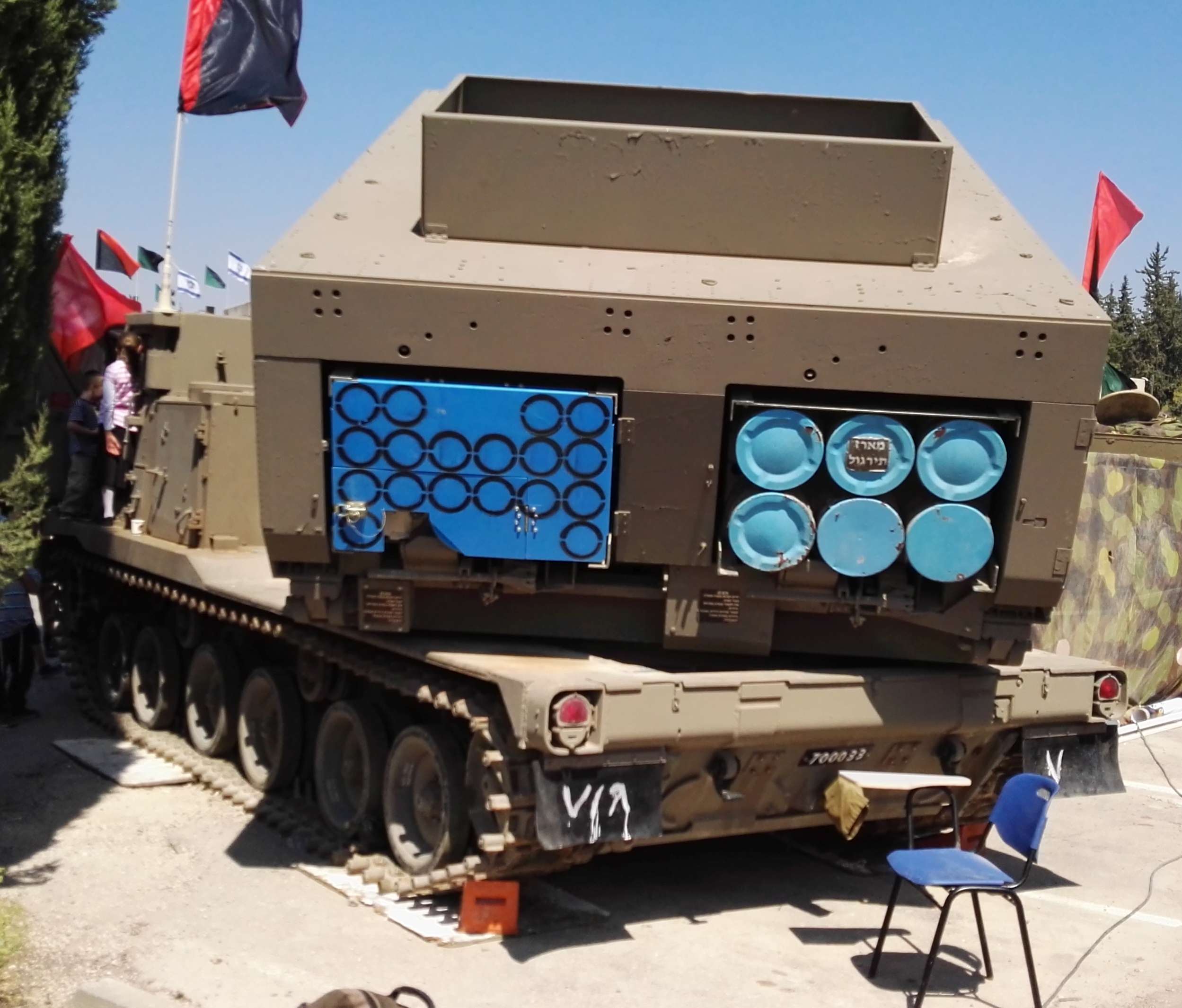

ACCULAR is family of artillery rockets developed and manufactured by Israel Military Industries (IMI) and used by Israel Defense Forces and international customers. It features 2 different calibers with a maximum range of 40km with a 20-35kg unitary penetration or controlled fragmentation warhead and accuracy of 10m CEP.[1]
