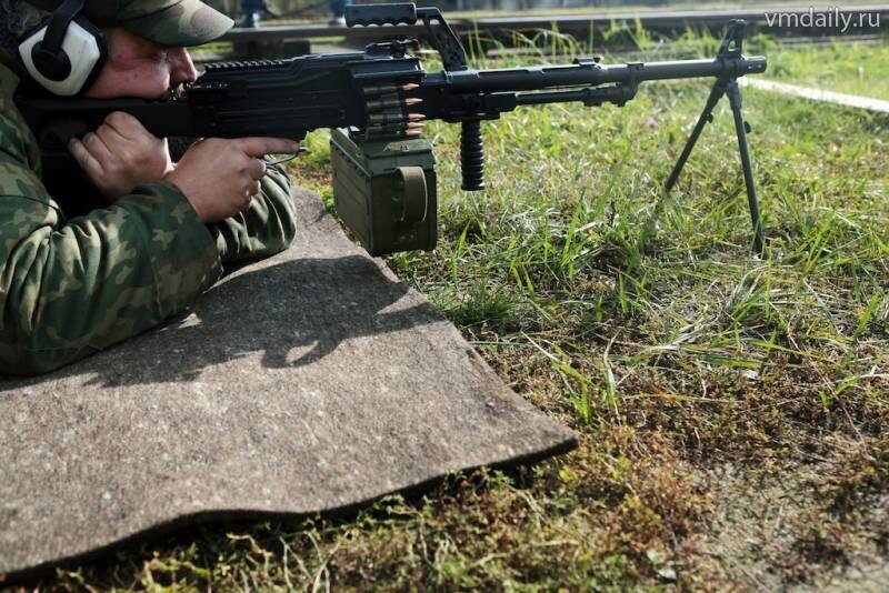

Tässä on ainakin moddattu PKM
BC7iSXNCcAA8aHd.jpg:large
New piston, Picatinny rails, new barrel with flash suppressor and vertical front grip. Squad Try going
