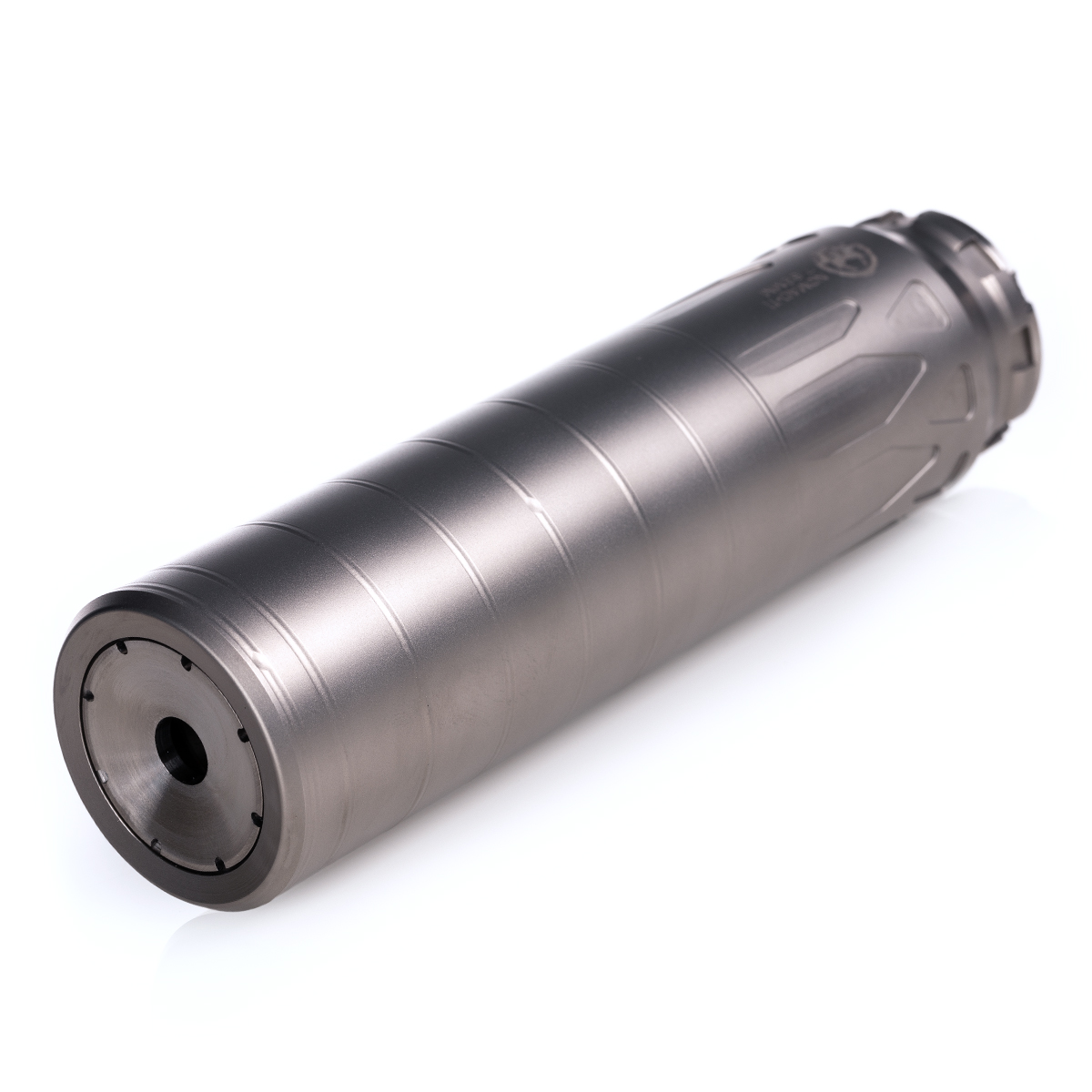

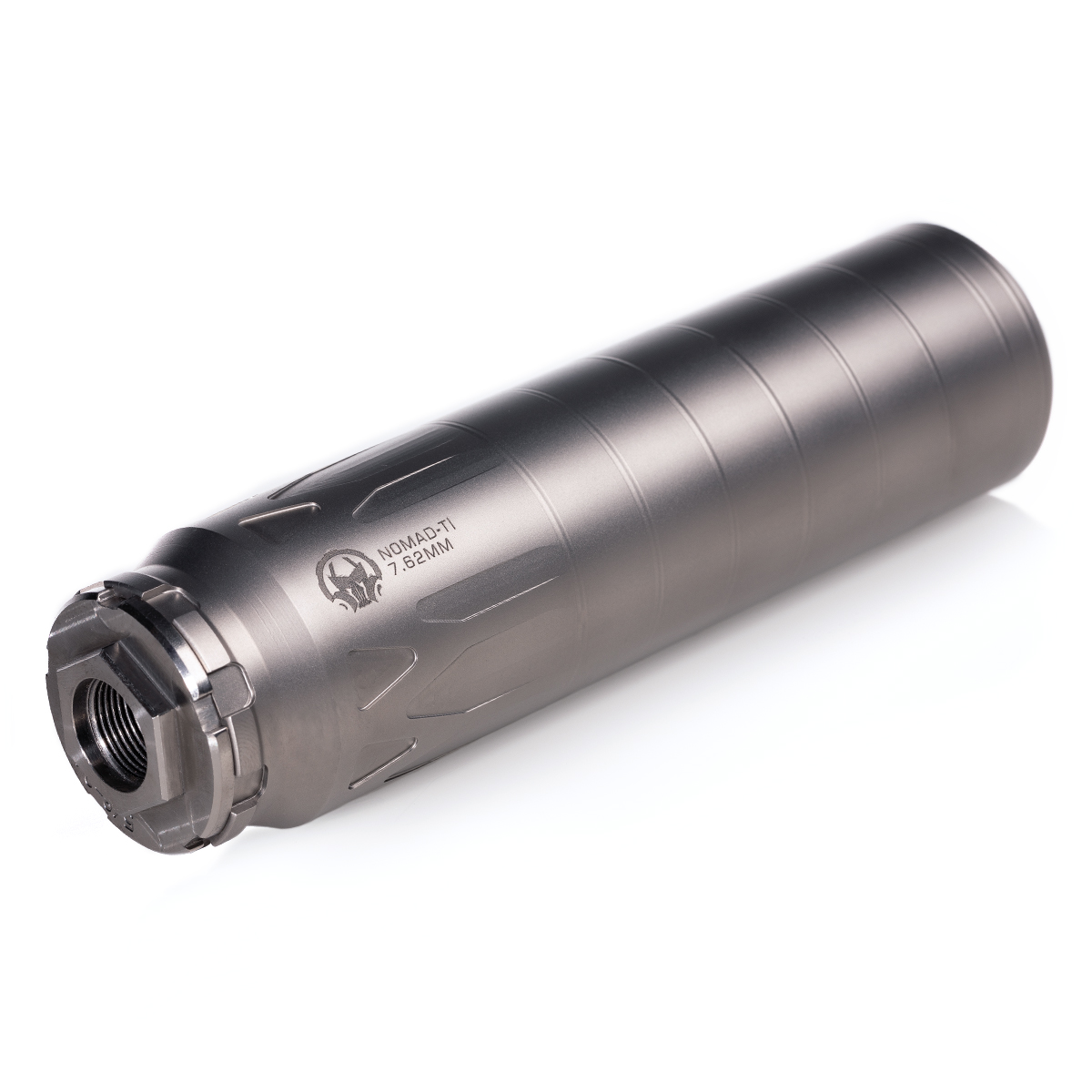

Dead Air Silencers Nomad-Ti 7.62mm Titanium Lower-Pressure Suppressor for Tactical AR-15 Carbines: 9.6 Ounces of Quiet Combat Capability!
By David Crane david (at) defensereview (dot) com April 14, 2021 Dead Air Silencers has introduced a rather nifty all-titanium 7.62mm lower-pressure rifle/carbine can (muzzle can, i.e., silencer/sound suppressor) called the Nomad-Ti that comes in at a relatively lightweight 9.6 ounces. The...defensereview.com
