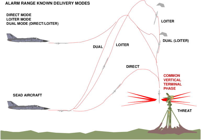

Milloinkahan joku tuo takaisin sen brittien ALARM-ohjuksen?
ALARM oli edistyksellinen ohjus ja sillä laitettiin pimeäksi Persianlahdella ja Jugoslaviassa sellaisia tutkia, joihin HARM ei pystynyt. Olisiko käynyt niin että suuremmissa volyymeissä tuotettu HARM /AARGM ja vähäiset tilausmäärät ulkomailta olisivat johtaneet ALARMin loppuun? ALARMissa oli jo 1990-luvun alussa käytössä sellaiset ominaisuudet kuin loitering-mode ja tungsten sirpalointi. Lisäksi ALARM oli n. 100 kg kevyempi kuin HARM.
The Air Launched Anti-Radar Missile
The ALARM is functionally divided into a seeker, a Mission Control Unit, a Navigation Unit, a Fuse, a Warhead Section, Rocket Motor Section, Actuator Module and Parachute Assembly. The missile is 4.3 m long, has a wing span of 0.72 m and a diameter of 0.224 m, weighing 584 lb (265 kg) at launch.
The Seeker is much like that of the HARM, an intelligent microprocessor controlled passive homing receiver, designed to recognise the characteristic Pulse Repetition Frequencies (PRF) of programmed threat emitters. The ALARM uses a wideband RF antenna/receiver subsystem. Material published in a Jane's reference suggests a conventional quartet of cavity backed spiral antennas, forming a fixed two axis interferometer with lower mid-band to hi-band coverage. The UK have neither disclosed nor confirmed any performance figures for frequency coverage. The Superheterodyne seeker is designed to operate in high density environments, selecting only programmed emitters with specific signatures (PRF). The seeker has ECCM features designed to defeat countermeasures. Like the HARM, the ALARM employs "flex" logic to select the highest value alternate target, should the primary target go off the air.
The Mission Control Unit contains the Zilog Z8002 microprocessor running the autopilot and navigation software, and the software which manages the missile's operation. The software is written in CORAL, a language commonly used in UK military embedded systems. The 1553B interface is tied to the MCU, which allows the missile to communicate with a suitably equipped launch aircraft. The Navigation Unit contains a BAe ALARM specific strapdown inertial package which produces the acceleration, velocity and position data used by the MCU software. The missile battery and launch aircraft power distribution adaptor are installed in the MCU module. The launch aircraft's power rails are converted to DC in the ALARM specific launcher, which feeds prelaunch DC power directly to the missile.
The Fuse module is unique to the ALARM, and employs a forward looking solid state laser rangefinder. Because the ALARM is designed to dive down vertically and pass abeam the target emitter, this specialised fusing arrangement is designed to measure the altitude of the missile precisely, and initiate the warhead as the missile passes the radar's main electronics enclosure (or antenna). This ensures that the warhead is as close as possible to the target when it is fired. The warhead is a preformed heavy metal (believed to be Tungsten) casing blast fragmentation device designed to produce high velocity armour piercing fragments which are intended to perforate not only the antenna, but also the supporting electronics and operator vans or enclosures.
The low smoke boost sustain burn profile rocket motor assembly and casing form the missile centre section. The motor exhausts through a blast tube which runs through the two tail section modules. The fixed cruciform wings are attached to the motor casing.
Aft of the motor casing and wrapped around the blast tube is the Actuator Module, which contains the four electrical servoes which drive the independent cruciform tail surfaces, which provide pitch and yaw control, as well as roll stabilisation.
The missile tail section houses the two stage parachute system used for loitering modes. In operation the rear fuselage shell is jettisoned and the drogue chute deployed, in turn extracting the main parachute. The missile then dangles from the main chute, scanning for a threat emitter.https://www.ausairpower.net/alarm-armat.html
ALARM hyökkäys ja toimintaprofiilivaihtoehdot:
Tarvinneeko tuoda takaisin? Riittää, että ohjus ei polta moottoriaan heti loppuun ja kykenee kiertelemään alueen yläpuolella.
En tiedä tarvitaanko, mutta olihan tuossa samassa paketissa myös mahdollisuus suoraan hyökkäykseen, mikä asettaa tiettyjä vaatimuksia moottorille.
