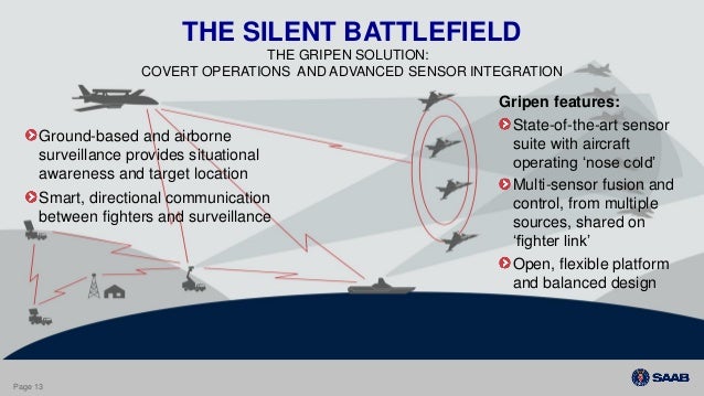

Gripen combines exceptional operational performance, highly advanced net-centric warfare, sensor fusion, unique BVR capability and cost efficiency with true transfer of technology and comprehensive industrial partnership. That’s why we call it the smart fighter.
saab.com/region/india/gripen
https://gripenblogs.com/Lists/Photos/sensor.jpg
https://image.slidesharecdn.com/saa...-farnborough-july-15-13-638.jpg?cb=1405410577
