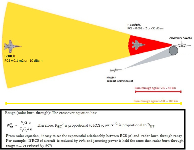

https://basicsaboutaerodynamicsandavionics.wordpress.com/2016/03/29/electronic-countermeasure-ecm/From radar equation, we can see that the power requirement for jamming will decrease directly proportional to RCS reduction, if the RCS of an aircraft is reduced to 0.1 (or 1%) of its original value, then consequently the jammer power required to achieve the same effectiveness would be 0.1 (or 1%) of the original value.
For example, a clean Rafale has radar cross section around 0.1 m2 (-10 dBsm) , an F-35 has radar cross section around 0.001 m2 (-30 dBsm) ,so the RCS value is decreased by 99%.Thus, if Rafale needs a 100 kW jammer to deceive or overwhelmed adversary radar, then a F-35 in the same situation, wanting to do the same thing will need a jammer with transmitting power of merely 1 kW.
Alternatively, if jamming power is kept constant and RCS changed then from the radar equation ,we can see that the burn through distance will be reduced dramatically.
