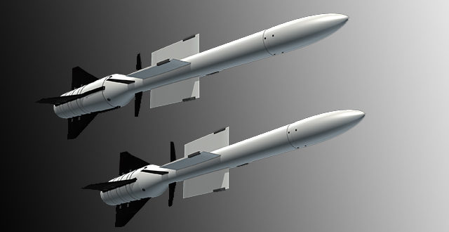

Toisessa kuvassa iranin uusien ohjusten väistöliike, joka on myös twitteristä tuttu. Tämänkin vuoksi torjuntaohjuksissa lienee ohjausta terminaalivaiheessa.
Erittäin kiinnostavaa tekniikkaa. Jotain tuon tapaista taitaa olla lingossa kun se on kerta hit to kill.
Tuossa laajemmin.
DACS is one part of the “PIF-PAF” control technique – namely, the PIF. PIF and PAF are two methods used to manoeuvre missiles. PIF-PAF is actually an acronym, PIF: Pilotage Inertiel en Force (Inertial Steering with Force) and PAF: Pilotage Aeronautique en Force (Aerodynamic Steering with force). One of them says “Use a force to steer the body”, and the other says “Use a force to change the aerodynamic properties to steer”.
The PIF, or, DACS is a non-conventional method which consists of blowing air or exhaust gases with a component that is perpendicular to the instantaneous flight path of the missile. This causes the missile to turn. The advantage of this method is that it allows the missile to turn in regions where there is low aerodynamic effectiveness – read, “low(er) speed”. Furthermore, a response time of only a few hundreths of second can be obtained by utilization of forces substantially passing through the center of gravity, and such forces can be acquired aerodynamically, or by lateral jets. In this case, there is little or no aerodynamic angle of attack pickup, but rather direct displacement of the center of gravity. Such a known mode of control called force control and designated hereinafter as PIF essentially supplies very high quickness of response.
