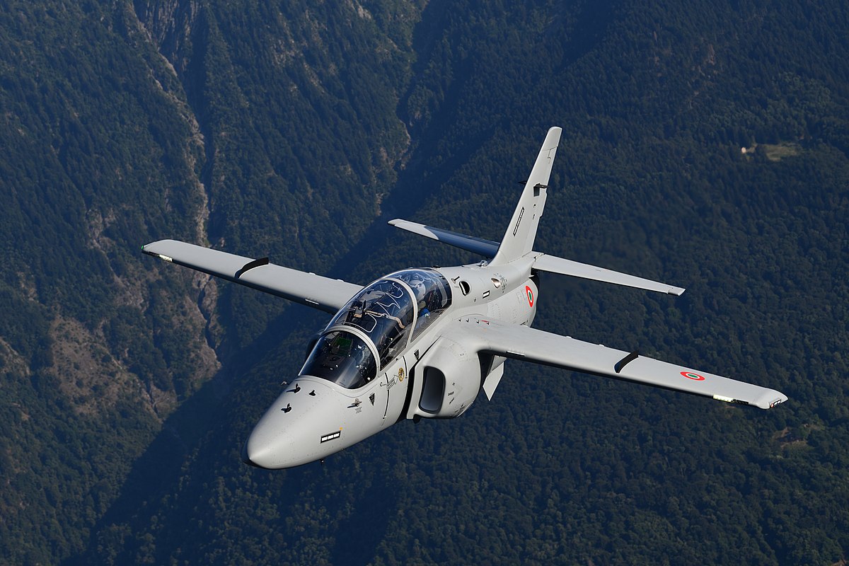

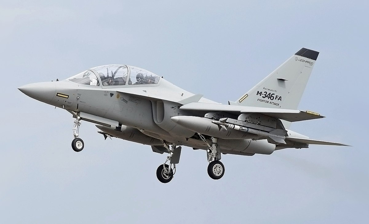

Frecce Tricolori vaihtaa kalliimpaan M-346 kuin aiemmin ajateltu M-345.
While the M-346 is designed as an advanced jet trainer, the M-345 is built to compete with equivalent turbo-prop basic trainers on operational costs.
