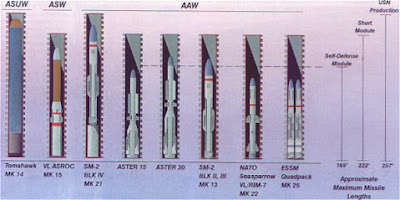

There is one outstanding program that may become a true standard: RIM-162 Evolved Sea Sparrow (ESSM) Block 2. The
original ESSM already excelled with its compactness, allowing four missiles to be packed into a single versatile vertical launch silo cell, unlike the French competition (
Aster) that uses a too wide booster stage and is usually coupled with a vertical launch silo type used for the two Aster versions only.

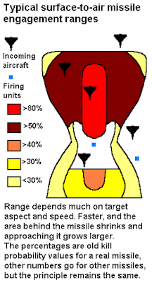

Important for the area air defence capability will be the actual engagement envelope. This is a very tricky story, even if we ignore the very tricky radar physics and poor reliability of published range figures.
I take two graphs from
here to illustrate this:
(note the waist: The smallest width of the dark brown area is the part of an air defence perimeter's circumference that the air defence system may cover well. This important metric is very different from the "range" figure and never published. It also depends a lot on the target, particularly its altitude, speed, changes of course and evasive manoeuvres capability.)
(this gap exists mostly for short range SAMs)
A missile with a published range of "80 km" may effectively protect other ships against missiles passing at a distance of 20 km at low altitude, but maybe the correct figure is "30 km", or "40 km". It won't be "80 km", though. At least the active radar seeker offers the possibility of engaging very low targets beyond the horizon (if the rocket engine offers enough energy for it).
