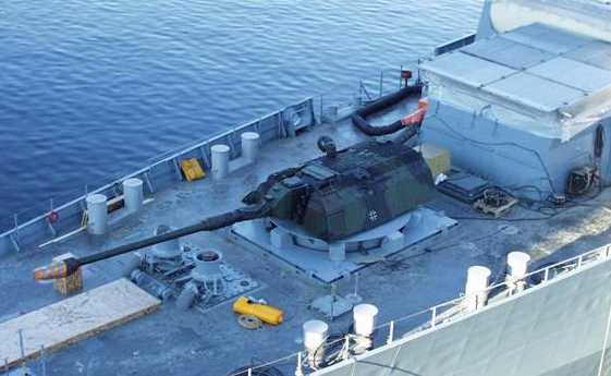

Harmi ettei Saksa saanut MLRSää toimimaan F125 laivoissaan. Se olisi ollut ihanteellinen saareen nousseen vihollisen tuhoamisessa. Muistaakseni korroosion kanssa ongelmia tms...
Edit. Näköjään ensin yrittivät saada keulalle MLRS 227mm heitintä, sitten PZH2000 155mm tykkiä Monarc nimellä, ja lopulta luovuttivat ja pistivät perinteisen 127mm Oto Melaran. Kuinkahan paljon tuo seikkailu maksoi :D

http://navalanalyses.blogspot.fi/2016/05/baden-wurttemberg-class-frigates-of.html?m=1
Etsiessäni Mark nelosen kohtalosta vihjeitä, löysin mahdollisen vastauksen toiseen kummajaiseen, miksi maailman suurimmassa frigatissa ei ole yhtä ainuttakaan VLS kennoa??
what is called today "the boxy superstructure" behind the 5-inch gun which is.. the gym of the frigate! The fact that this is the gym, which is actually an empty space full with a plethora of machines for fitness exercises, may leave the possibility for an installation of few VLS modules. I believe the assumption of the space for future installation of a VLS is indeed valid and the existence of a gym in that space allows for future additions of new weapons. That's why I have mentioned in the image where I depict the weapons and electronic equipment on the ship, that perhaps there is a provision for a future installation of a vertical launching system. The installation of a VLS will transform these large German frigates into something more than "just" a frigate reminding the Deutschland class heavy cruisers of WWII which were very well known as pocket battleships due to their heavy armament but ships' very small size
