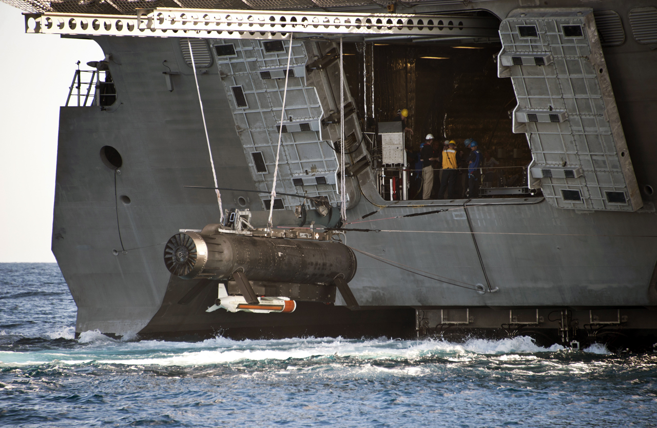

Latest updates on the AN/WLD-1 Remote Minehunting System
www.navaldrones.com
Lockheed Martin's AN/WLD-1 RMS is a key component of the Littoral Combat Ship's mine countermeasures package. The system consists of a 7 meter semisubmersible autonomous Remote Multi-Mission Vehicle (RMMV) which tows the AQS-20A Variable Depth sensor. The RMS has sometimes been referred to as a "snorkeler class" unmanned surface vessel due to the snorkel required above surface for the system's diesel engine operation. The RMMV can be pre-programmed to perform autonomously or be manually controlled via line of site or over-the-horizon data link.

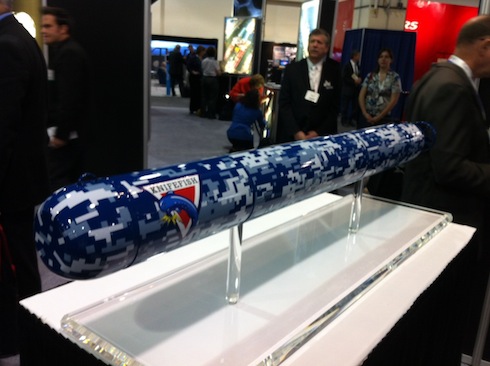

USN:n Knifefish UUV:n, joka on miinatiedustelija, proto muutama vuosi sitten...
Information on the US Navy's Knifefish & Artemis UUV
www.navaldrones.com
Navy Reliant AUV Sets Mission Endurance Record
20 November 2013 - U.S. Naval Research Laboratory's (NRL) Acoustics Division, with Bluefin Robotics, executed a record setting 507 kilometer (315 mile), long-endurance autonomy research mission using its heavyweight-class mine countermeasures autonomous underwater vehicle (AUV), Reliant.
The NRL Reliant autonomous underwater vehicle (AUV), an advanced version of the Bluefin Robotics, Bluefin-21 vehicle, is the prototype for the new U.S. Navy Knifefish mine-hunter. The Reliant, shown here, outside New York City after completing a record setting endurance of 109 hours traveling nearly 315 miles.
