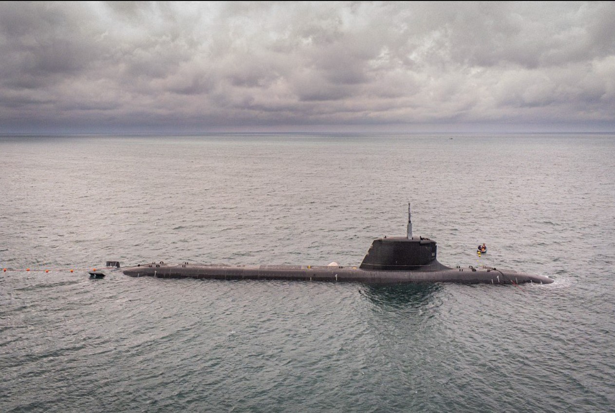

France's new nuclear-powered sub launches MdCN cruise missile for first time
FS Suffren test-launched the Naval Cruise Missile (MdCN) in the Bay of Biscay during its sea trials.
