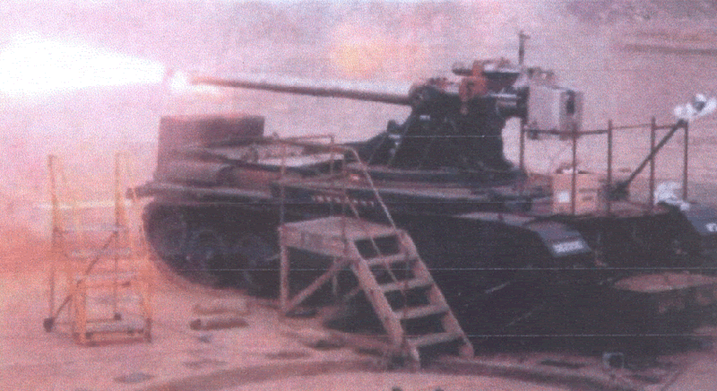

Problems Encountered with Higher Caliber Tank Guns
