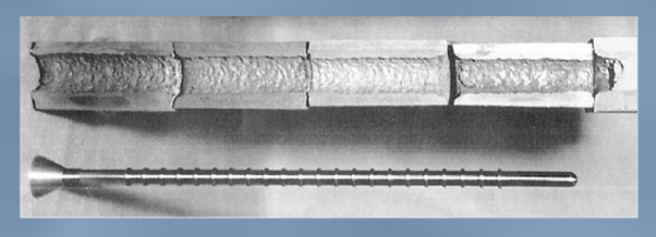

For equal projectile and target mass densities the equation predicts that the penetration depth is approximately equal to the length of the projectile, as illustrated by tests done at the Australian National University with their railgun and aluminum rods against aluminum targets (impact velocities up to 5900 m/s).
main-qimg-4de7c5ffd2edf1b7f03c963fc4ebd56e
The generated dynamic pressure are however in the same order of magnitude of the Hugoniot Elastic Limit (HEL) of certain ceramics, so for ceramic armour materials the actual penetration depth will generally be slightly to moderately reduced from the predictions made with the hydrodynamic penetration equation.
