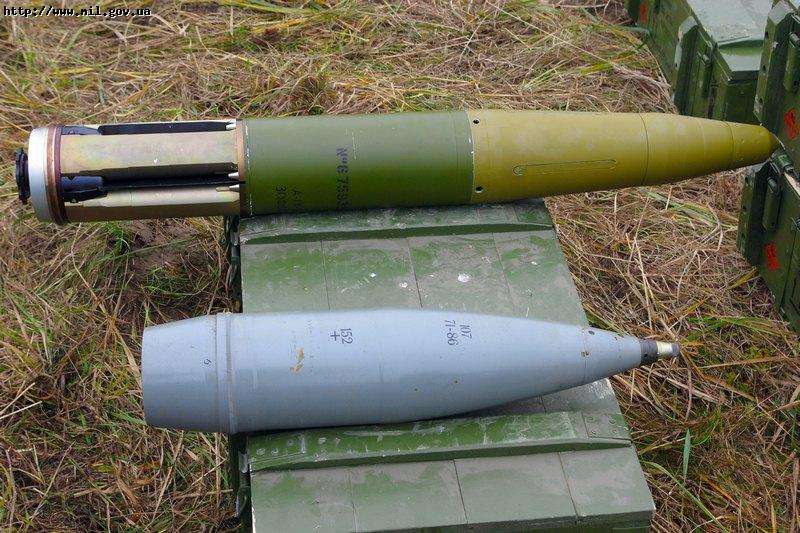

The 152-mm Kvitnyk Cannon-Launched Guided Projectile is tested at the International Center for Peacekeeping and Security of Hetman Petro Sahaidachnyi Academy of Ukrainian Land Forces.
“Considering the experience of leading designers of high-precision arms, our enterprise has developed its own product. New Ukrainian projectile is designed to hit armored vehicles, command posts and other sheltered targets and integrated to ground artillery systems 2S3 Akatsia or MSTA-S. The time of task accomplishment and the number of projectiles used are effectively reduced,” said Mykola Klochkom, Enterprise Senior Designer.
Its high technical characteristics were proved during Perspektive 2012.
The Kvitnyk uses a Semi-Active Laser guidance system what improves targets hitting.
The precision and effectiveness of the projectile are striking. “The most important targets were defeated during a short period of time and by means of less quantity of projectiles,” said Captain Dmytro Yuschenko, Commander of Battery participating in the testing.

Mitenkähän meinasivat käyttää noita vastatykistöön, kun tuo on laser ohjattu? Meinaan, että hommaan taitaa olla kätevämpiäkin varusteita.
