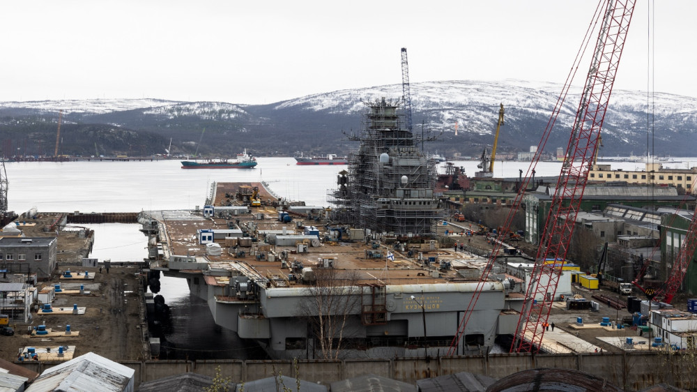

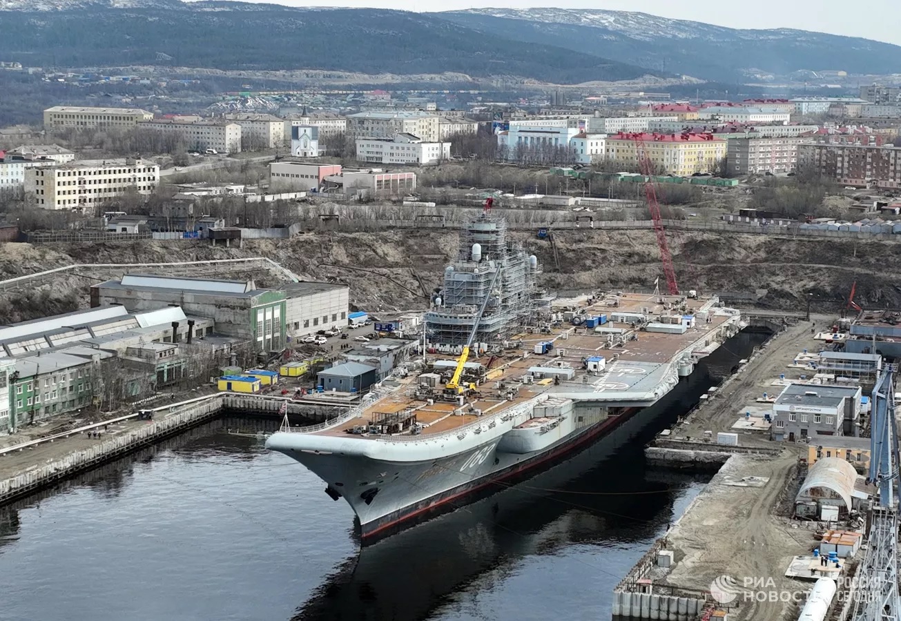

Admiral Kuznetsov on siirretty telakka-altaaseen. Telakan kelluva sulkuportti, batoport, ei kuitenkaan ole valmis, joten ovat päättäneet käyttää väliaikaisratkaisua, jonka rakentaminen saattaa jälkimmäisen linkin mukaan kestää pari kuukautta.
"This was confirmed to the RIA Novosti agency by the General Director of the United Shipbuilding Corporation (USC) Alexei Rakhmanov. "The docking operation for the Kuznetsov has been successfully completed," Rakhmanov said. According to him, this operation was planned to be carried out on May 14-15. "However, a strong wind rose up to 17 meters per second, so we decided to postpone the operation until more favorable weather," the USC head explained.
The docking of the Admiral Kuznetsov, according to earlier reports, will be carried out until September 2022.
In April 2018, the Ministry of Defense of the Russian Federation signed a contract with USC to carry out a medium repair and limited modernization of the aircraft-carrying cruiser Admiral Kuznetsov, to be completed in 2021. Since the fall of 2018, the cruiser has been located at the 35th Shipyard branch of Zvezdochka Ship Repair Center JSC. Due to the delay in work, including the delay in the rebuilding of the dry dock at the 35th Shipyard, in May 2021, the management of the USC named the end of 2023 as the new date for the transfer of the ship to the fleet after repairs."
"As previously reported, work in the dock with the ship must be completed by September, and the cruiser itself must be taken out of the dock before freezing, otherwise the continuation of work will be postponed to 2023. The main problems now are not with the ship itself, which will be taken to the dock, but with the closing of the dock to pump out water. The thing is that the batoport for the dock is not yet ready, so a temporary bridge will be built to cut off the dock from the sea. According to preliminary calculations, it may take up to 2 months to build a bridge and pump out water. After carrying out the work, the jumper will be permanently removed, the cruiser will leave, and the dock will stand in this state until next summer, when the batoport will be installed."
