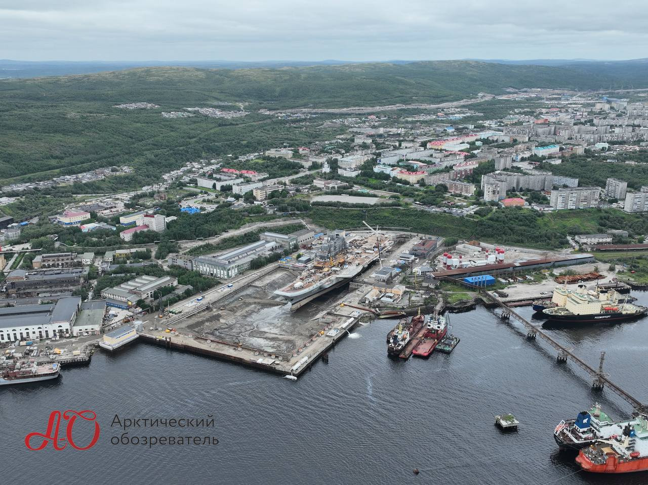

Admiral Kuznetsov päässyt jo (lähes) kuivalle maalle.
"Repair in a hurry?
July 30, 202212:10
To repair the only aircraft-carrying cruiser "Admiral Kuznetsov", the dock located at the Sevmorput plant (35 SRZ), which is part of the United Shipbuilding Corporation (OSK), was drained. According to some reports, in the near future, Kuznetsov will begin a full-fledged repair - they will update the deck, replace the power plant, and more.
The photographs of the "Arctic Observer" show that the "Admiral Kuznetsov" has already been installed on special stands ("soles"), and the water from the dock is almost completely pumped out. At the same time, massive imperfections attract attention - somewhere the base of the dock is concreted, but in some places the soil bottom is visible. It can be assumed that the further arrangement of the dock will be carried out in parallel with the repair of the cruiser - both on the Kuznetsov and around it, activity is already noticeable: the entire deck is filled with change houses, equipment and special equipment.
Let me remind you that the TAVKR "Admiral Kuznetsov" got into a new dock in mid-May . Previously, it was assumed that all repair work would be completed by September 2022, however, according to the Arctic Observer, the completion date for the modernization has already shifted to at least the beginning of 2023."
Pari tuoretta kuvaa Venäjän intternjetistä. Hauskana yksityiskohtana telakka-allas on niin kesken, ettei siinä ole edes varsinaista porttia - laivan eteen on rakennettu työpato.
Kyllä tuo näyttää haudalta. Eli saattohoito alkanut.
Tietoja on myös liikkunut K:n remontista, että monin paikoin laivan sisällä ei päästä korjauksia tekemään lainkaan myrkkyjen ja vaarallisten vuotojen vuoksi. Rakenteet ym. useissa kohdin jo lopullisesti romuttuneet niin, että tuskin koskaan lähtee merille tuosta kuopasta.
Mitä (ja miksi) tuolle lentokannelle tehdään huollossa, että se alkaa kauttaaltaan ruostumaan? Muistaisin vastaavia kuvia nähneeni muualtakin maailmassa eli kyse ei liene pelkästä ryssimisestä.
Reactions: PSS
Kansi lienee pinnoitettu jotenkin normaalisti. Ehkä pinnoite on poistettu uusintaa varten ja metalli päässyt ruostumaan.
Kiitos vastauksista. Itse mietin, että jos kyseessä on pelkkä pinnoitteen uusiminen, kannattaisi uusi pinnoite vetää pintaan mahdollisimman nopeasti. Tuskin se ainakaan paremmin ruosteen päälle tarttuu.
