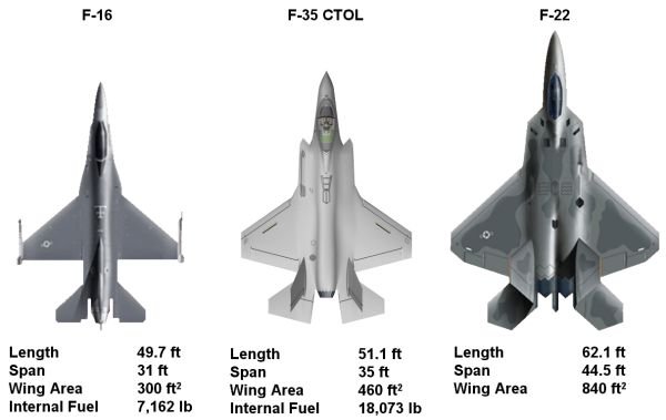

So by Pierre Spray's own argument the horribly turning F-4 should fly circles around his hotrod F-16? What’s happening here?
Well the F-16 does not rely on just wings to produce lift, it has a blended body and wing design, plus LERX that produce vortices above the airplane (if you remember you physics, high pressure below + low pressure above creates lift)
around 40% of the F-16s total lift does not come from the wings at all. So in reality the F-16's actual wing loading when loaded with 8,000lbs is closer to 49 lbs per square feet not 81 lbs.
The F-35 is the same. to get the F-35 to have 110lbs / sq ft of wing loading as Pierre Spray said it needs to carry 21,300 lbs of load.
The f-16 can never do that, but the F-35 can! that’s what’s great about this plane, it gives you options, if you need to go to a long range mission then sure, the F-35 CAN carry 18,000lbs of fuel and 18,000lbs of weapons.

So as you can see at dogfighting weights, the F-35 is not bad at all, its not the best but really not all that bad.
Now consider this, the F-35 probably has the most efficient body lifting surface of all these aircraft due to the fact that its fuselage has the smoothest flatest surface of all these planes, not a lot of disturbance for the wind to flow around on.
So lets give all these aircraft a Body lifting coefficient of 40% but to be conservative lets give the F-35 45%, the truth is probably much larger but hey lets keep it down.
Wing loading plus body lift:
Mig-29 (M/M2): 54.6
F-16C (block 50): 54
F/A-18C: 46
F-35A: 44
Su-30MKI: 43
The F-16s wing loading is similar to the Mig-29s which is why it replicates the Mig-29 in RedFlag.
But Notice how the F-35's wing loading is so close to the F/A-18 and just 1 pound above the Su-30, which is why when you ask pilots they will say that the F-35 maneuvers like an F/A-18 with better acceleration.

Valitettavasti tämä kaveri on melkein yhtä pahasti kujalla kuin Pierre Sprey (jonka nimen hän kirjoittaa väärin). Väite että F-35:llä olisi mainituista koneista paras rungon noste on aika rohkea, ja veikkaanpa että asia on pikemminkin päinvastoin: eihän F-35:ssä ole esimerkiksi juuri minkäänlaisia LERXejä. Pikemminkin F-35:n runko näyttää harrastelijan silmään siltä että se on suunniteltu matkalennolle matalaan vastukseen, mikä olisikin sopusoinnussa vaatimusten kanssa. Mitä kiihtyvyyteen tulee, niin epäilenpä ettei F-35 ole tässä suhteessa kovin ihmeellinen, tietysti moottorinhallinta edustaa uusinta teknologiaa mutta ison ohivirtausmoottorin tapauksessa jo fysiikka aiheuttaa rajoituksia.
Ja jälleen kerran, vertailu käy puhtaasti legacy-koneisiin. Joo, ihan kiva että kone pärjää 2030-luvulla 1970-luvulla suunnitelluille koneille. Mites sitten suu pannaan kun vastaan ei tulekaan enää legacy-koneita?
No, F-35 ja F-22 noudattaa kyllä samaa aerodyaamista suunnittelufilosofiaa. Ei F-22:ssa ole LERX:ejä, ja silti se on erittäin liikehtimiskykyinen. Eikä sen liikehtimiskyky ole pelkistä kääntyvistä suihkusuuttimista peräisin...
Mitäs sellaisia ei-legancy koneita onkaan olemassa? Ainakin kiinan ihmeet J-31 ja J-20 näyttävät olevan kooltaan isompia ja painavampia mutta vanhoilla ja tehottomilla moottoreilla varustettuja. F-135 ohivirtaussuhde on muuten sama kuin uusimmissa Sukhoissa kaytetyissä AL-31F moottoreissa, ja PAK-FA:n moottorit pitäisi olla tuosta kehitettyjä mutta suuremmalla puhaltimella, tuskin siinä ainakaan ohivirtaussuhde pienenee. Ja nuo Kiinalaisten ja Venäläisten havittelemat uudet moottorit ovat vielä enemmän vaiheessa ja päiväunta kuin nuo koneiden prototyypit jotka sentään on saatu ilmaan.
Stealth ja sensoriominaisuudet taas riittävät hyvin kaikkia ei-stealth koneita vastaan.
F-22:ssa on kääntyvät suihkusuuttimet ja paljon enemmän tehoa. Sekin kyllä luultavasti hetkellisessä kaartokyvyssä häviää monelle muulle koneelle, mutta muiden ominaisuuksien vuoksi sillä on varmaan harvoin merkitystä.
Minä katselenkin tilannetta meidän näkökulmastamme. 15 vuoden päästä tilanne tulee näyttämään aivan toiselta. Viimeisten Su-27 -versioiden teho/painosuhteet tullevat nousemaan F-22:n tasolle, PAK-FA on tullut tuotantoon, kiinalaisetkin lienevät saaneet viritettyä moottorinsa kondikseen. On aivan turhaa vertailla F-35:ttä johonkin MiG-29:ään ja todeta että joo, no problem. Meillä on jo nyt kone joka pärjää MiG-29:lle. Seuraavan koneen pitää pärjätä uudelle sukupolvelle.
Itse asiassa molemmat kyllä hyödyntävät Vortexeja, mutta hiukan eri tavoin synnytettynä ja toimintakin hiukan erilainen ilmeisesti. Minullakin on kyllä jostain mielikuva, että F-35 ei ole silti yhtä hyvä kuin F-22. Voisiko se johtua siitä, että F-35 ilmanotto on taivutettu sisäänpäin?

http://en.wikipedia.org/wiki/Lockheed_Martin_F-35_Lightning_II
Unlike the F-16 and F/A-18, the F-35 lacks leading edge extensions and instead uses stealth-friendly chines for vortex lift in the same fashion as the SR-71 Blackbird.[261]
Just, testilentäjien mukaan mm. F-35:n hetkellinen kaartokyky on erinomainen, samoin sen kyky lentää suurilla kohtauskulmilla.
Noissä käytetään LERX:in sijasta eturungon osalta muotoilua josta käytetään englanninkielessä termiä "Chine":
http://en.wikipedia.org/wiki/Chine_(aeronautics)
F-22 edestä:
F-35 edestä:
Väitätkö että tehopainosuhde, joka siis F-35:llä on hyvä ja jonka moottorin kehityspolku on vasta alussa (teho 191kN -> testeissä ajettu moottoria yli 220kN teholla), on jotenkin ratkaiseva tekijä ilmataistelussa F-22:n tai F-35:n ja Su-27 varianttien välillä? Ihan vinkkinä, häiveominaisuudet ovat muuttaneet pelin hengen ihan kokonaan. Ja PAK FA ei näyttäsi olevan siellä terävimmässä kärjessä häiveominaisuuksien suhteen. Mutta kuitekin PAK FA on juurikin se kone minkä vuoksi medän nimenomaan täytyy hankkia häivekone seuraavaksi koneeksemme. Ja F-35 on ainoa speksit täyttävä häivekone meille tarjolla n. vuonna 2020.
Ja noita venäläisiä ihmekoneita, moottoreita ja ohjuksia on saatu paperilla ihailla jo 90-luvulta lähtien. Olen vähän skeptinen noiden suhteen noin niinkuin teknisesti, länsimoottoreista muuten saataisiin heti se 10 - 15 prosenttia tehoa lisää pelkällä moottorinohjausjärjestelmän uudelleenohjelmoinnilla, mutta se johtaisi sitten yhtä lyhyisiin huoltoväleihin kuin mitä noilla venäläismoottoreilla on.
No juu. En tiedä mahtaako sillä olla merkitystä että onko nuo ilmanotot taivutettu sisään vai ulospäin. Joka tapauksessa nuo F-22:n ilmanottojen yläpuolella olevat lipat ovat kovin lyhyitä verrattuna vaikka F-16 ja f/A-18 koneiden LERXeihin.
Ero tullee siitä että F-22 on isompi kone, eli jos teknologia on muuten saman tasoista niin isommassa koneessa pilotin, heittoistuimen, tietokoneiden, tutkan jne. osuus koneen kokonaismassasta ja tilavuudesta on pienempi, eli suurempi osa koneesta voi osallistua kineettisen suorituskyvyn tuottamiseen (moottorit + polttoaine). Näin ollen isomman koneen tehopainosuhteesta voidaan tehdä parempi ja siihen voidaan laittaa isompi siipi (joka laskee siipikuormitusta) ilman että sen ilmanvastus huonontaa koneen muuta suorituskykyä liikaa. Mutta iso kone kahdella moottorilla on tietysti kalliimpi.
Tätä ei ihan samalla tavalla voi verrata jos iso ja pieni kone edustaa erilaista teknologista tasoa, esim. Venäläisten Su-27 (-30, -35) koneet ovat hyvin isokokoisia jotta pystyisivät kilpailemaan vähemmän kehittyneen venäläistekniikan kanssa pienempiä länsikoneita vastaan. Esimerkkinä voisin mainita että venäläisten uusimmissa Su-3X varianteissa käyttämä AL-31F moottori vastaa tehopainosuhteeltaan lähinnä 70-luvun P&W F100 moottoria. F-22:n P&W F119 ja F-35:n P&W F135 edistavat tältä osin ihan eri sukupolvea. Samoin on tutkien laita, venäläistutkat ovat suorituskykyynsä nähden isoja ja painavia.
Erinomainen, verrattuna mihin?
Kyllä väitän. Merkittävä osa siitä miksi F-22 on ylivoimainen on juurikin valtava moottoriteho. Kone on niin nopea ja hyvin kiihtyvä että se dominoi BVR-ympäristöä jo pelkästään sillä - ennenkuin tutkat ja stealthit edes astuvat kehiin. F-35:n ominaisuudet sen sijaan tässä suhteessa eivät eroa edellisen sukupolven koneista.

Epäilen että F-22 ei olisi meille sopiva kone, en usko että USAF niitä koneitansa meille myy, enkä usko että hintakaan olisi sopiva meille vaikka kauppoihin olisikn heidän taholtaan valmiutta.
Concordekin lentää korkealla matkalentoa yli Mach 2 nopeudella ilman jälkipolttoa, vaikka sen tehopainosuhde on todella vaatimaton verrattuna hävittäjiin. Suuri moottoriteho ei ole välttämätöntä suuren nopeuden saavuttamiseksi. Lentokoneen suunnittelu on kuitenkin tasapainottelua erilaisten ominaisuuksien ja vaatimusten suhteen. Joka tapauksessa F-22:n dominointi nimenomaan liittyy häiveominaisuuksiin, todellinen supercruise ja pitkä toimintamatka ovat kiistämättömiä etuja ilmaherruushävittäjälle, mutta tuollaisella koneella pitää ehdottomasti pysytellä kaukana vastustajista ja ampua ne alas ennen kuin joudutaan lähietäisyydelle.
F-22A on kinemaattisesti suorituskykyisempi kuin F-35A koska se on isompi (ja kalliimpi). Aivan kuten F-15C oli suorituskykyisempi (ja kalliimpi) kuin F-16C. Enemmän tilaa moottoreille ja polttoaineelle suhteessa ilmataisteluhyötykuormaan. Mutta meillä ei ollut varaa ostaa F-15 koneita aikoinaan, eikä varmaan olisi varaa ostaa mitään muitakaan ilmaherruushävittäjiä tulevaisuudessakaan. Pitää siis tyytyä melkein yhtä hyvään, eikä meidän Ilmavoimien käyttötarpeille ehkä ilmaherruushävittäjä oliskaan parasta resurssien käyttöä?
