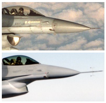

Sitä ihmettelen että miksi ainoastaan jenkit ja kiinalaiset ovat panostaneet DSI teknologiaan (SAAB on myös tutkinut muttei testannut tuulitunnelin ulkopuolella) siinä missä muut ovat suunnitelleet hävittäjiinä tavalliset ilmanottoaukot.
Etuja näyttää olevan enemmän kuin haittoja.
During the mid-1990′s, Lockheed modified the forward structure of a block 30 Viper in an attempt to prove technologies that would be part of the looming Joint Strike Fighter tender. Diverterless inlet technology utilizes a hump on the inboard side of a jet intake along with a forward swept outer intake fairing to separate boundary layer air and to slow down airflow reaching the jet’s engine face during supersonic maneuvers. It does this without moving parts and allows for the deletion of heavy and complicated intake diverters, intake ramps and cones. Also, by allowing for smooth transitions between a combat jet’s fuselage and intake, such configurations can provide a drastic reduction in radar cross section, thus lowering an aircraft’s detectability on radar, especially those that function at higher bandwidths
http://aviationintel.com/fast-history-lockheeds-diverterless-supersonic-inlet-testbed-f-16/
http://www.codeonemagazine.com/article.html?item_id=58
http://www.codeonemagazine.com/gallery_slideshow.html?gallery_id=84
