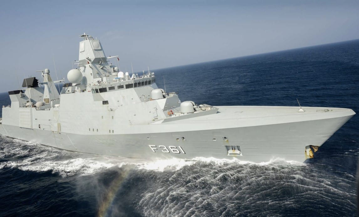

Iver Huitfeldt on ilmeisesti ollut niin ongelmissa Punaisellamerellä, että vedetään ennenaikaisesti pois! Thalesin tutka ja Terman CMS paskovat keskenään. 4 dronea kyllä pudottivat, mutta ESSM ei kyetty laukaisemaan ja 76 lahot sytyttimet mahdollisesti jopa aiheutti vaurioita alukselle.
(hyvä pitkähkö juttu hollanniksi)
Missähän määrin meillä on piilossa vastaavat yllätykset? Hutheja vastaan on vielä hyvä koeponnistaa.
***The Danish appear to experience some serious issues with their AAW frigate deployed in the Red Sea. A problem relating to APAR/CMS interaction prevented launch of ESSM. After that bad fuzes on 76 mm ammo appear to have caused early detonations close to the ship.
Its worth noting this follows on the heels of German frigate Hessen also experiencing issues with her APAR/CMS earlier, causing bad guidance on SM-2 and apparently also preventing successful use of ESSM in a later engagement.
Unlike Hessen the Iver Huitfeldt appears to have been recalled early from her deployment. The German Navy previously stated that the technical issues with Hessen have been rectified. The ship hasn't engaged any further Houthi drones so far (its helicopter did though).
Serious technical problems on Danish frigate Iver Huitfeldt during attack in Red Sea. Ship was unable to launch missiles due to an issue between Thales' APAR radar and software in the command center. Half of the cannon shells exploded near the ship.
Ernstige technische problemen Deens fregat tijdens aanval Rode Zee
Iver Huitfeldt kon geen raketten lanceren en granaten ontploften te snel na verlaten kanon
